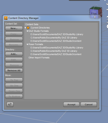

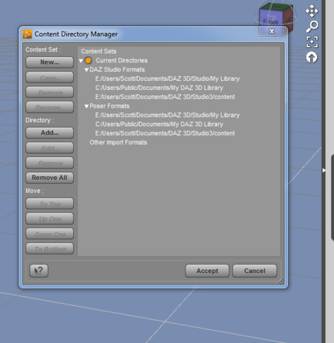

    It sounds like your Content Directory Manager might not be seeing everything, you might need to tweak the settings. Open it (right-click on the Content Library tab header), open all three categories and post a screenshot here.
  • edited December 1969
    See attached screen shot.
    588 x 603 - 64K

    That path isn't listed in your screenshot. You need to install to one of the content folders you have listed there.

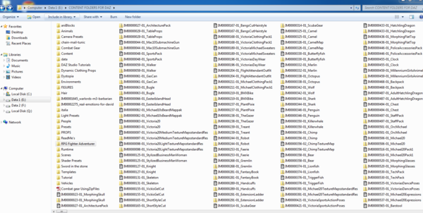

    See attachment. It looks like E:/Content folders for Daz IS the place that DIM places it's unpacked contents on the installers. Otherwise, what am I looking at here?
    1575 x 794 - 202K

    Edit: just saw your posted pic. What you're looking at there are the downloaded .zip files put there by the DIM. The unpacked files that the DIM extracts from those .zips are in one of the CDM locations, probably the one ending with /My DAZ 3D Library/.

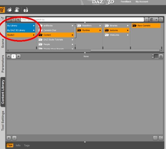

    OK, I think I finally got the Camelot "content" folder where it should be but DAZ still doesn't read the files that are inside the folder. See attached screen capture. It looks like it recognizes the folder but nothing that is inside of it.
    853 x 764 - 36K
  • fixmypcmikefixmypcmike Posts: 19,719
    edited April 2013
    That folder contains the texture jpg's -- they shouldn't be visible, and the fact that the folder is (and the Runtime folder itself) means your content folders aren't defined correctly. Only the folder containing Runtime should be listed as a content folder.
    The material presets to apply them should show up in "Poser Formats > [content folder name] > Pose > Camelot-Chars" if the content folders are defined correctly.
    ETA: in that latest screenshot it looks like you changed the content folder from ...\Studio3\Content to just ...\Studio3
