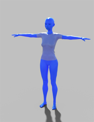

As we all know, custom figure morphs have a tendency to cause conforming clothes to cling in certain areas:
Now, while I enjoy a wet t-shirt as much as the next guy, it's not always a good look. Wouldn't it be nice if there was an easy way to create custom fit morphs for clothing that solved this problem without having to do any sculpting, or even having to leave DS?

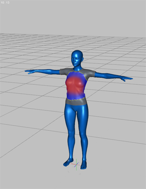

10. With the shirt selected, Create -> New dForce Modifier Weight Node
11. Add a new Influence Weights map
12. Paint the map to look something like this:

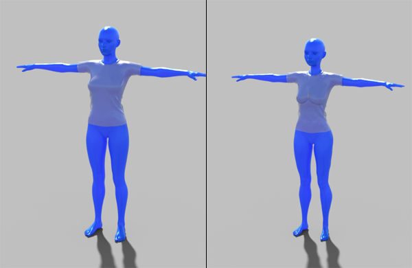

18. Use Morph Loader Pro to import the .obj you exported earlier and create the anti static cling fit morph.
Hope this helps someone!
