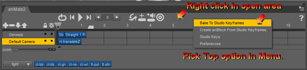

  • JaderailJaderail Posts: 0
    Superdog said:
    I'm using a walk aniblock in Animate 2. How do I send it to the timeline? I'm using DAZ Studio 4.5.
    Like this.
    882 x 202 - 38K

  • SuperdogSuperdog Posts: 765
    Jaderail said:
    Like this.
    Ok, thanks. I've baked the walk aniblock to the timeline but when I playback the animation the translate parameters still don't change in the 'parameters' tab.
    I'll be Darned Your right. I did the Camera in Animate as a SUB now I'm lost as to how I did it.
