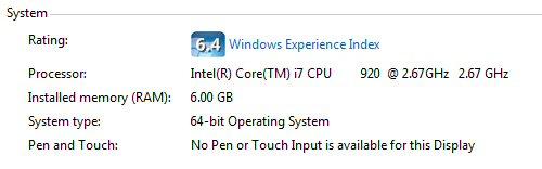

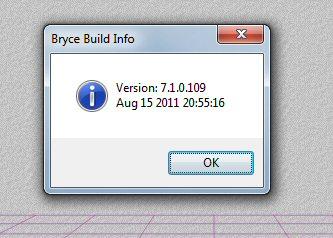

    I have found the DS bridge moves intermittently between barely usable and totally broken. I can't offer any particular insight, but I can say what is currently working for me.
