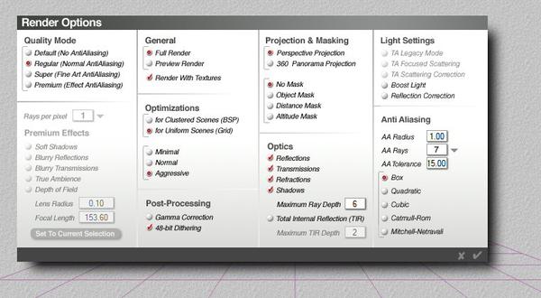

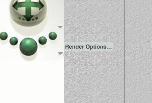

  • David BrinnenDavid Brinnen Posts: 3,136
    Post up a copy of your Render Options... see images attached, and that might offer a clue.
    If you do have Depth of Field set, here's a little video I made about it that might help Bryce Depth of Field effect - a 15 minute tutorial by David Brinnen

    I think all of the replies contained part of the problem. Thank you for that.
    @ Oroboros: I moved the camera up and it helped.
    @ David Brinnen: I did play around with the Depth of Field, although I think the posted image was with the default setting. I will definitely look at your video (and your other videos too).
    @ Horo: You are right that it is picture material. I don't know what procedural means - I still have to learn that. But I did change the texture to a higher quality picture and also increased the frequency, and it helped.
