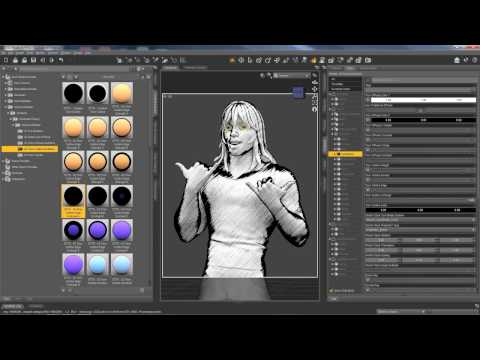

  • The only one I know of at the moment that is specifically for Iray is Sketchy - Toon Edge and Art Shaders for Iray.  It's a great shader set and you can do a lot with it if you practice.  The vendor also has a video on how to use it.  So, you can check that out to see if it will do what you want.  I like it.  It's a nice tool to have in the NPR toolbox.
