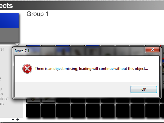

this comes up when I try to load an object it imported alright from daz but even if I click on it to try to delete it this message comes up and the only way to stop it is for me to right click the task manager and shut Bryce down....I was going to go in the back way and pull the whole object preset out but for some reason unknown to me all of the obps and mat files I loaded are gone(I can see them from Bryce when I am working on something ) but not listed with the object titles I created...Thanks in advance Trish

    Don't know what sort of object you try to import. If there are a lot of missing objects, several may pop up. Though most of the times you end up with nothing imported - but at least Bryce runs.
    If you can properly load the object into Studio, export it from Studio with another name or send it over the bridge to Bryce.

  • Dave SavageDave Savage Posts: 2,436
    Is the problem that when you click OK in the warning window, it just puts it back up again?
    This can (and does) happen when the model that's missing has a lot of components and it will put one these warning windows up for each component. Sometimes you can sit there clicking that OK button for long time until it's gone through the whole list of components, and then when it's done you have a blank scene.

    Yes Savage it just keeps throwing up the ok and I can't get it to stop no matter how many times I click
    Guss; I exported as an wavefront obj its that Andoria city and it showed up ok I saved it to the obp file and now when I click to get it up again it throws the missing obj thing.....I would just like it gone...out of Bryce the Andoria city thing but I can't find it going through the back of the program all of my files don't show up....in fact none of them do...but they show up while I'm in Bryce working on things...Whats up with that they used to show up???? I named the catagories...

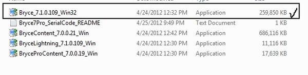

  • David BrinnenDavid Brinnen Posts: 3,136
    You are running the up to date version of Bryce? Here is how to check. Bryce 7.1 Pro - Help, About Bryce - a short video by David Brinnen
    Well now I've seen what the model is, I'm guessing it's got hundreds of components so you'd be pressing that OK button hundreds of times.
    Not that it will get you anywhere as the model will load empty after you've done all that.

    ok heres where i am so far....don't have Norton (that has caused me problems before so I got rid of that)....I checked and I have the newest Bryce version.....I did a search and it will not take me inside the Bryce program it leads me to public/public documents/Daz3d/bryce/content.......which is Hdri,content,lens flares tutorials...ect. I am glad not to be the only one with this issue ...I am thinking of uninstalling the whole thing and starting over....Don't know if that is the smartest idea I have ever had though. p.s. I am running windows 7

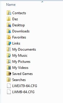

    Sean; I can not find this app data/local/virtual store ....ect as per your instructions when I go to c/users my name then I have......This see below...Is this secret copy hidden somehow I can't find it

  • GussNemoGussNemo Posts: 1,855
    bullit, are you trying to find what Sean gave you on your 'C:' drive or your external drive? Not only will you find Bryce within the AppData folder on the 'C:' drive, but many other programs. C: -> User -> your user name -> AppData -> Local -> VirtualStore -> Program Files -> DAZ 3D -> Bryce 7. Sorry if this is repetitive, but following Sean's information I find on my computer what Sean is talking about by following the above path.
    I don't know if it's hidden, but one way to find out is to go into Control Panel -> Folder Options -> View and scroll down until you find the selection that hides folders. If that box is checked, uncheck it then see what you get when you click on C:\users.
    Hang on, I just had a thought. You're only getting the window you posted after clicking on User? When you log onto your computer are you going in as administrator or regular user? Have you set up an administrator/regular user account in Win 7? If you haven't set up an account in Win 7 that may be the reason you don't see anything but the window you posted. Win 7 doesn't know you want to get into a specific account. I don't know Win 7 that well to tell you how to set up a user account, so if you do need to set up an account Google will be your best friend to find the information.
