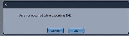

What I tried is this:
- load a mesh (again, a DAZ dog)
- export the mesh as wavefront obj
- DO NOTHING (except for drinking that tea that has been sitting in its cup way too long)
- call up vertex modeler
- select morph tab
- create a new morph channel
- re-select the created channel
- import obj file (the one saved above)
- result: "An error has occured"

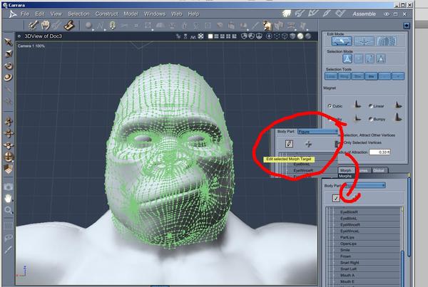

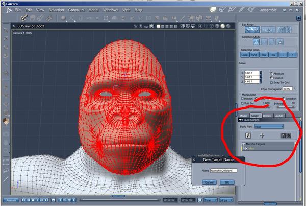

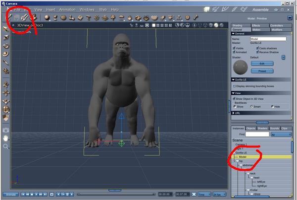

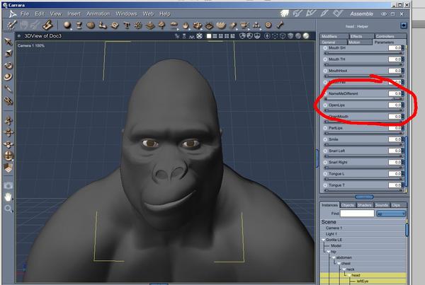

    I hope the following image series is of some help to anyone trying to find her/his way through the morph creation "in theory". Not that several steps sometimes will not work (randomly), e.g. it happens quite often that the morph does not get transferred to the model's parameter list, so that it can only be used within a vertex-animation-setup.
    Image 1 shows a loaded complex model. Select "model" (or "actor") and call up the vertex modeler.
    Image 2 shows the selection of the domain you want to work with, it seems important to use "select by morph area", since everything else has gotten me into various depths of trouble.
    Image 3 shows the workflow to use: Call up "Morph", select the body part you are dealing with (which is misleading, sometimes you have to select the "morph area", sometimes the "Body Part" or whatever, naming convention seems to change constantly within Carrara). Try to find a way to create a new morph target (which sometimes works by using the right mouse button and calling "create target"), sometimes you have to activate kind of a "parent directory" ("Misc" on the screen shot) to be allowed to do that. Name your morph target, click ok.
    Image 4 shows several steps in one: After you have created a new morph target Carrara will throw you out of your workflow completely. You have to reselect the "body part"/"morph area" (whatever is displayed) and manually find your newly created morph target. Activate that - and scroll all the way back to the top of the list, because Carrara will immediately stop your workflow again by not offering the next logical steps "at hand", but hiding them at the top of the morph target list. The little stamp-in shows the start situation: With your own morph target selected (and NOT shown, in my case) click on the "pen icon". That will green-light the selected morph area on the model.
    NOW you can edit the morph - or actually EXPORT the morph as whatever-interchangable-object by cicking the disk-symbol. Either use Carrara's modeling tools OR an external application to create the final morph status (do not add/delete vertices, of course).
    After finnishing the morph either LOAD the newly created interchangable object OR click on the checkmark (where the red arrow is pointing to), thus storing the morph in the morph target. SAVING and LOADING of the object MAY NOT BE DONE through the software's saving and loading functions, because this would seem natural and we are not dealing with natural things here. ONLY use the save/load-functions within the morph-area next to the checkmark (or the pen tool). Everything else will not work reliably. Or, to be more precise, everything else will reliably not work reliably, whilst using the functions mentioned here you will often get something working.
    Note: This step does not always work, the modifications you made will sometimes just be lost now. Note: Importing the modified object does not always work (check and eventually fiddle with export/import settings). Note: It is possible that your morph target now vanishes from the list and cannot be brought back. Note: You may get an "an error occured", which does not mean that an error occured, but in fact that a theoretical thunderworm has been skilized on Iupiter's second moon by a stonedrunken fly.
    Image 5 shows that after having left the vertex modeler (by clicking the hand tool in the upper left, returning to the assembly room) you SOMETIMES get your freshly created morph target in the moprh list. Sometimes it will appear in the body area where you assume it to be (because you selected "head" when starting your journey). Sometimes it will only appear under the complete figure's list. Sometimes it will not appear anywhere - in this case you have to call the vertex modeler in order to use the morph, click on "animation mode" (center icon on the right top), dial in the value in your morph and leave the vertex modeler again (your morph has then been applied through the animation system).
    Summing it up:
    It works. About 7 times out of 11 it does actually give you results that remind an unattending visitor of something you might have said about being your objective.
    Rule of thumb: Save early, save often, use different filenames and don't expect the saved data to be of any help later, because sometimes you will just get "an error occured" referencing some action on Iupiter's second moon.

    Image four shows magnet settings and all images show that you've never left the assembly room.
    I don't know what to say.
    I've never used the export and import stuff you mention, but each and every morph that I've made follows the rest of your example pretty well, except that I've never had one not work, or show up. Hmmmm....
    Then again, I never do it in the Assembly room, I always double click the model which enters me into the actual Vertex Modeler room. Also, I never right click to add a morph, I just click the plus sign to the right of the pencil icon.

    HI Timlemi :)
    I did actually read through most of the relevant information you wrote,. I skipped some of the ranting stuff :) we all need to rant sometimes, but it detracts from your real issue..
    The series of morph creation steps you posted,. show that it's possible to create morphs in carrara. even on protected content.
    the fact that you're saying it works,. and sometimes it doesn't ... is down to the work-flow you're using,.. and inexperience of how carrara works.
    sometimes you're doing it correctly,. and sometimes not.
    You're trying to work the same way you would in a different application,. EG: export morph target as OBJ, then import obj...
    But,. many programs work in different ways, and have differently named functions, or tools, which essentially perform the same function.
    Learning how one program works doesn't automatically translate to knowing how all programs work. or expecting all programs to work in the exact same way.
    even text editors and Daw's have different ways of working, and different functions or work-flows.
    also, you're working with (Imported) content, designed to be used in Poser or DS, where the users don't have access to functions which could destroy the mesh, UV mapping, Rigging, Weight painting,.. etc.
    This is why DAZ3D and Poser content is initially "protected" in Carrara, and that protection can prevent you from editing the mesh, and potentially breaking the way the model works.
    Carrara is a self contained 3D working environment, where the user can model, texture, rig, animate and render, without requiring any other application. so, you can make an animated figure with morphs, entirely in Carrara without using import or export.
    What isn't supported in Carrara is exporting that figure and it's custom morphs as a New Poser / DS compatible figure.
    If that's your goal,. you should use DS plus Hexagon. or Poser to create those figures. not carrara.

    Sorry, I clearly run into dead ends without involving other programs. Weird error messages are not really a sign of the user doing "everything wrong", but a sign of propable flaws in the software.
    Trying to quit Carrara sometimes gives me this (see below). So using the program at the state it is in does not make sense to me (version 8.1 is not that stable either and lacks too much functionality). Sorry, I seem to have stumped people on their feet here, I really thought "give and take" would work, so I put up the work of showing some walk throughs, maybe helping others. I regret this now.
    I feel more frustrated than from using Carrara by the seeming impossibility here to accept that there are SERIOUS problems in Carrara that are not being addressed for years (according to the bug center). Saying that bugs are user's errors doesn't solve anything, sorry.
    I apologize to have bothered you. Won't happen again for some time.
    Gust
