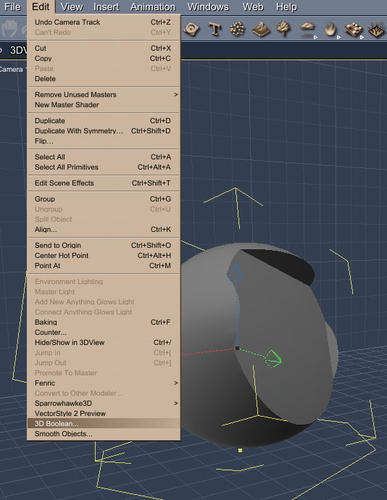

    In the Vertex modeller,. it's under the "Construct" menu,. (pic 1)
    (boolean will only highlight when two objects are selected)
    or,. it's also an icon on the top tool-bar,. there are options on the right hand panels to change the Boolean type from Add / Cut / intersection etc..
    In the Assembly room,. it's an option in the "Edit" menu / 3D Boolean,.. (Pic 2)
    then there's a pop up window where you can select the type of boolean,. Cut / Add / intersection.

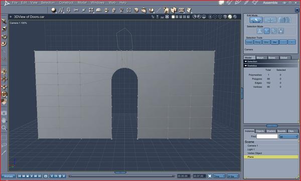

  • VIArtsVIArts Posts: 1,539
    Doors, door frames, and doorways o different shapes. I made this doorway by matching verticeson the X and Z axes so they made the same shape as the door, then just deleted the polys.
    But i forgot the door frame. lol
