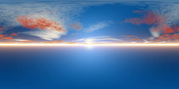

    @laskey - instead of using the skydome only, use the full sky. Export as Radiance.hdr 96 bit and spherical. Then, in a HDRI-compatible graphics application, set the lower half to black if it disturbs you to have light from the undersife. A spherical panorama to be wrapped spherical on a sphere must have the aspect ratio of 2:1 (width:height). If you program only accepts domes, the aspect ratio should be 4:1. In any case, Bryce will output spherical as 2:1. Here's an example - tone-mapped, of course. Sun at 0° azimuth and 2° elevation.
    1288 x 644 - 122K
