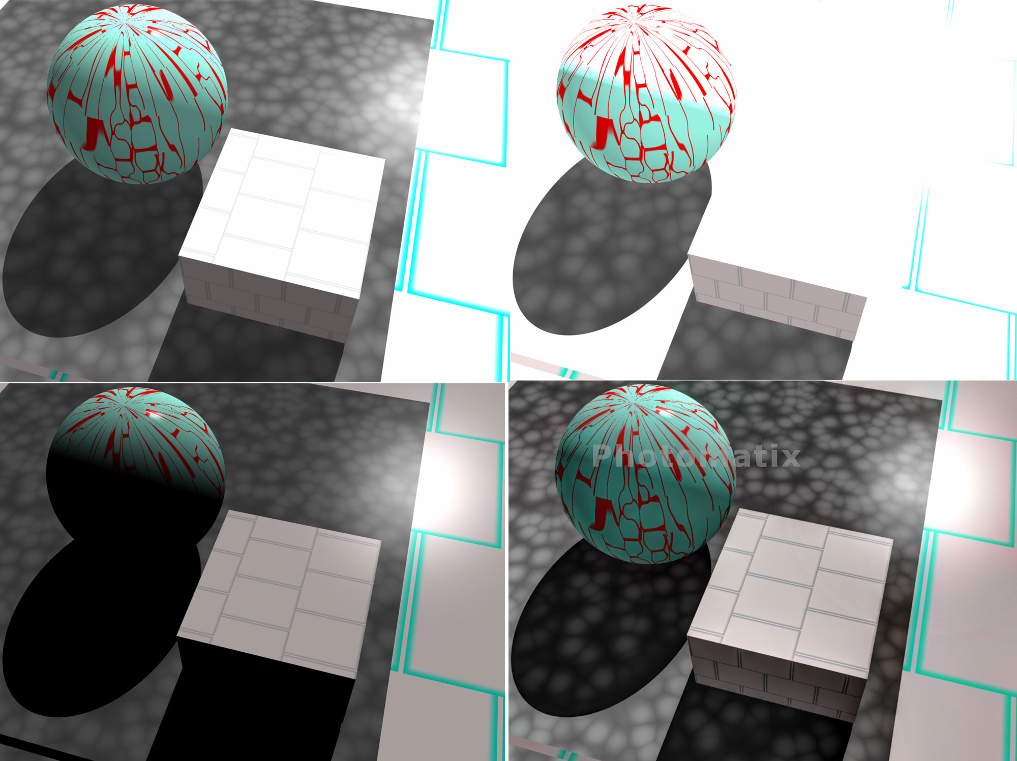

    I was looking for some renders that I did of object contact points demonstrating ambient occlusion and found this;
    out of interest here are three renders combined in hdr software to produce one image
    you render with diferent lighting setups to get your details - sometimes it helps..
    from the discussion here https://www.daz3d.com/forums/discussion/16378/using-hdri-software-to-enhance-carrara-renders/p1
    this is with one light bulb and lots of caustics - the reflected light from the walls and floor  does most of the work
    out of interest here are three renders combined in hdr software to produce one image [ cut image... just look up/back]
