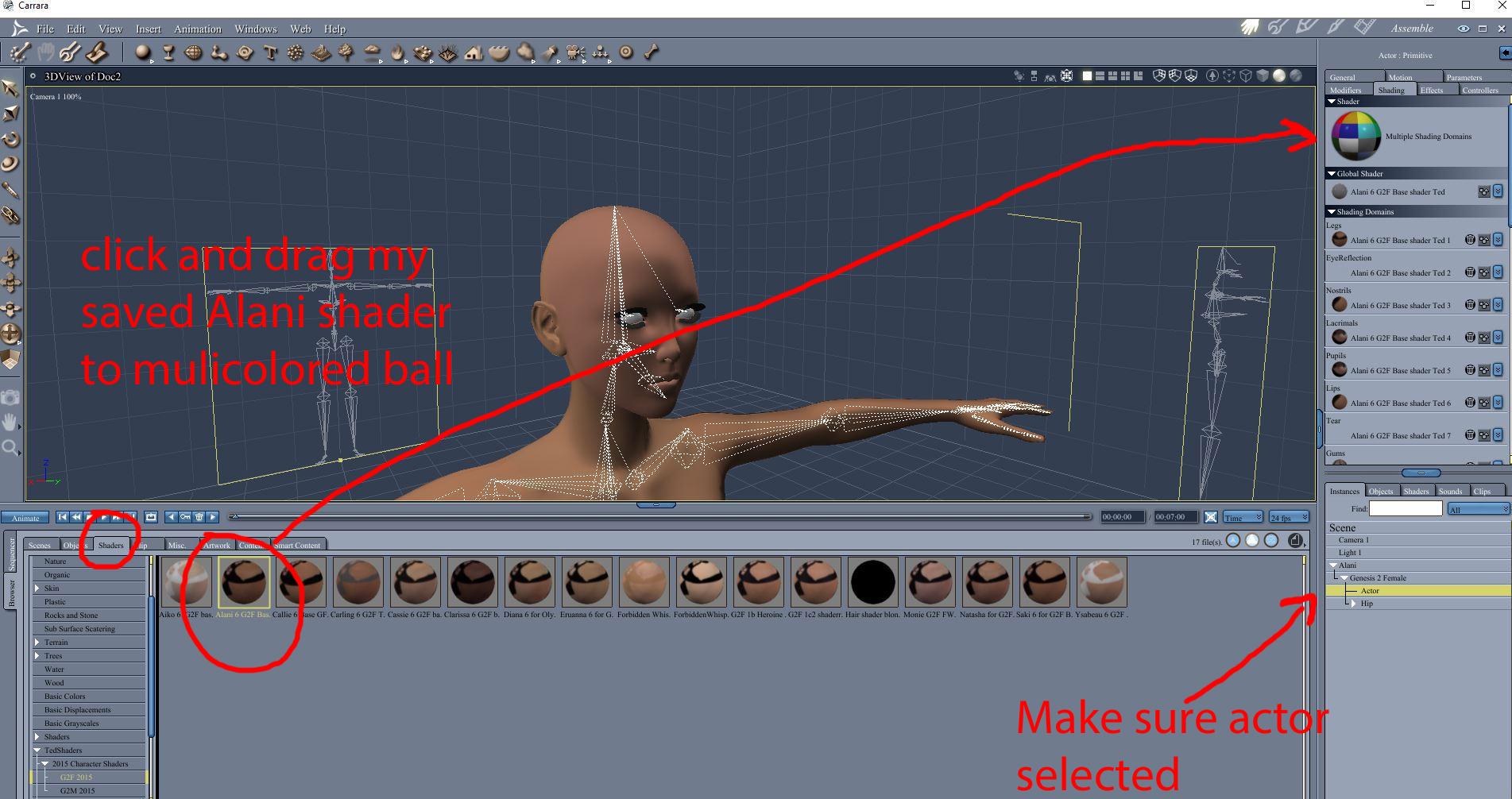

    RE: QUESTION: How/Where do I save the customized material preset [shader?] once I have it adjusted for Carrara?
    The attached pic shows how to drag a shader from the shader browser to the globe.  You want to do the opposite.  If you create an optimized set of shaders for a character, then once you are fnished, just click and drag from the globe to the bottom shader browser area.

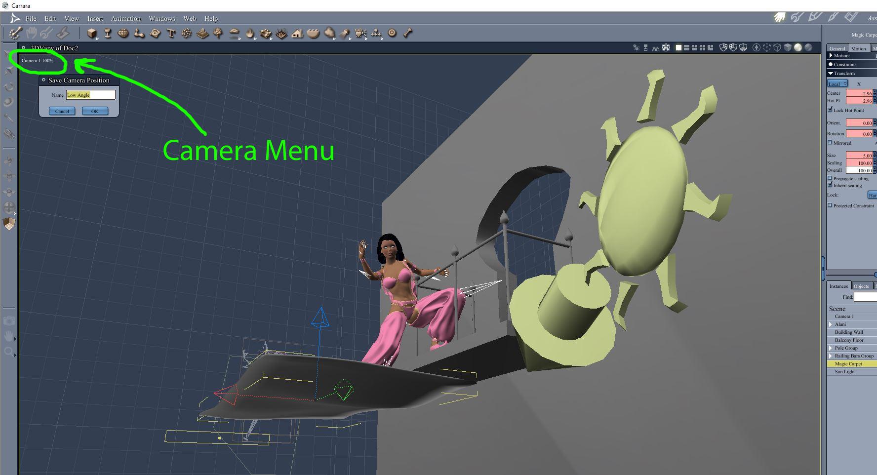

    RE: QUESTION: Does Carrara have an equivalent to Daz Studio’s Create Camera feature? With that feature in Daz Studio, I can scoot around the Perspective View — or any camera really — until I find a good angle, then Create Camera, then designate the new camera to Use Active Viewport Transforms. It will then position itself at the good angle I found. Can Carrara do the same?
    You asked several camera questions.  This pic shows where the camera menu is within the assemble room.  You can use this to switch camera views for cameras in the scene.  You can also save a camera angle for later use from this camera menu. In addition, you need to know that you can insert a new camera from the top menu, using INSERT : (...)      where the (...) represents either conical, isometric, or spherical.

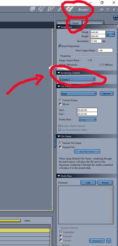

    RE: setting the camera to use for the render
    Go to the render room and look under the output tab.
