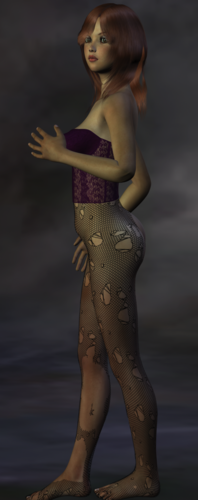

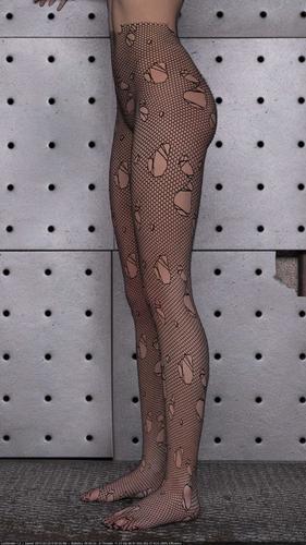

    Ok - here are two screen-shots, one is a Reality render (not run for long but you can see where it was going), the other a 3Delight render with a couple of spots and a distant light. You can clearly see that the texture doesn't transfer to Reality very well at all:

    I can't remember how reality works but that is a tiling issue. You need to increase the texture tiling either in DS pre-transfer or in Reality

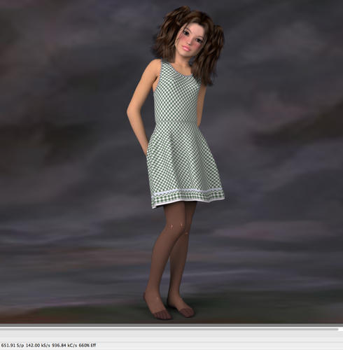

    And this is one rendered for a few minutes in Luxus. The texture seems to have transferred more effectively but I have not got the hang of controlling shadows or hair yet (obviously).

  • cwichuracwichura Posts: 1,042
    I purchased the stockings as well. The stocking shader appears to be based on DAZ Default Shader, so most of the important settings come across in Reality. It gets all the texture maps in the correct slots. For some reason, however, it does not read the tiling information from this custom shader, despite tiling info working for the base DAZ Default Shader in Reality. So you need to manually set the tiling for each of the texture slots (it's the "more options" entry in the gear icon to the right of each texture slot). The glossiness value also comes in pretty low, and will need tweaking.
    But overall, I'd say this set is quite usable in Reality/LuxRender, with just a few minutes time to correct the tiling settings.

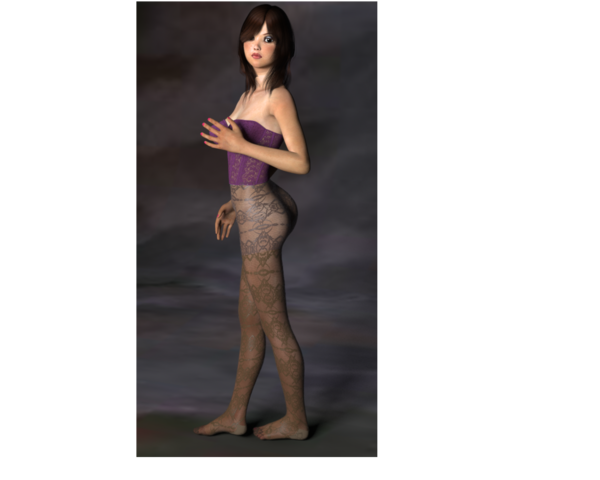

    Well - I noted that the Hor/Ver tiling in the DAZ Studio surfaces tab were both set to 6 so I set the tiling values to the same (6) for all thirty-one of the materials in the Reality settings. Made absolutely no difference at all. :(

    I suspect that you missed some of the places to set the tiling. There are five texture map slots for each material, and you have to set each one of them to the tiling size.
    However, there's an easy way to do this automatically. Apply the shader to the stockings. (It seems the Having Fun presets are saved using the bumpmap versions instead of normal maps. You'll get better results in Lux if you use the normal map versions. If you run the shader apply script that is included, it has radio buttons at the bottom to select between normal and bump maps.)
    After you've applied the shader in Studio, select all the surfaces of the stockings (just click on the stocking header and it will automatically select all the subsurfaces). Now apply the dzDefault shader. This will revert the surfaces back to the plain DAZ Default Shader, but it will keep all the texture map/etc settings. Now when you invoke Reality, it will see the tiling information and automatically apply it to all the correct slots.
    I've just done this as a very quick test and I am getting the expected tiling. See attached. I set the glossiness to 8000 and enabled surface fuzz.
    Also, these shaders make use of displacement. There are two things to watch for here with that. First, they set the negative displacement to 0. Reality has a bug where it uses the default value of -.001 instead of 0 when it sees 0. So you need to multi-select the surfaces of the stockings and then set the displacement minimum to 0. I would also recomend bumping the displacement levels up to 2. The second issue relates to a change in displacement handling in Lux 1.2, where they fixed a long-standing bug with the inversion of displacement. Reality has been working around that, but now it does the 'wrong thing' when Lux 1.2 is used. The most recent version of Reality has a change to detect when Lux 1.2 is being used and correct the dmscale when detected. However, there seems to be a bug in that as well, where it only remembers that for the current session of DAZ Studio. So if you close DAZ and then re-open it, the first time you invoke Reality, you need to remember to go to the output tab and reselect the location of LuxRender (even if it's in the same place) so that Reality will emit the correct dmscale value.
    And yes, when I said I see this set as more of a shader set than necessarily the stockings (though it's nice to have a multi-zone set of stockings for Genesis now), I was talking about using them on other clothing as well. And yes, the tiling issue would apply. But it's easily worked around by reverting the surface to the DAZ Default Shader.

  • marblemarble Posts: 7,501
    Much better Reality effort ...
    1280 x 1024 - 753K
