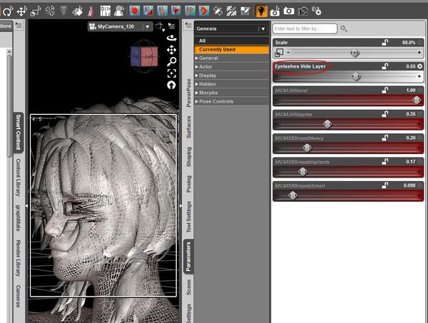

  • kitakoredazkitakoredaz Posts: 3,526
    Yes,, it is bug about one of genesis Evolution morphs.
    Actor/Head/Face/Eyes/Universal/Real World
    you can find Eyelashes Hide Layer
    or \data\DAZ 3D\Genesis\Base\Morphs\DAZ 3D\Evolution
    PHMEyelashesHideLayer
    no one hope character eye lush hide layer morph to auto follow hair sahpe.
    there is no meaning , never.
    eyelush hide layer morph pull part of eye lush into the head skin. and hide them.
    so it change hair shape ugly.
    I recommend when you find these "auto-follow" morphs
    which need not follow hair, (but usualy they need auto-follow,,,)
    change the morph properties to not auto-follow in parameter setting tool,
    or edit code, not to auto follow, and save it to keep "not auto follow"
    if leave it off, whenever you apply character which use this morph,
    and hair fit to, the morph cause same problem with (fit to) hair.
    there are some character which use this morph, and auto set value.
    (I use save modified assets, take care not change other properties
    it cause more problems,when you load genesis)
