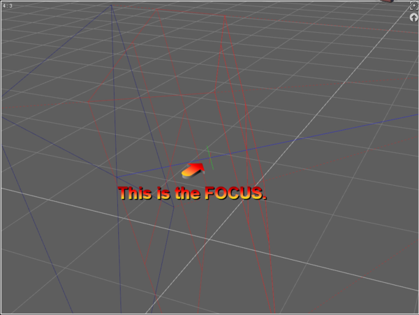

    If you Load Both Cameras as you have been doing and LOOK real close there is a FOCUS mark on the DOF depth line (the long one from the center of the DOF camera). As you change The Depth (Spread the Planes) it should Show as an X on that line. That is what you place on your main Figure to get the fully in Focus for it part. Then as Scott points out Items Before the Front Plane and up to the X will have the Proper DOF and items behind the Rear Plane and behind the X will also have the proper DOF.
    EDIT: Here it is....

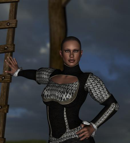

    Here's a quick scene I threw together in a few minutes to test DOF. It's definitely not a fantastic picture. But I have DOF!
    Edit: the DOF is more noticeable when you click on the picture and see the original size. The wood grain on the tower she's leaning against is quite detailed in the original prop, so there's definitely some blurring going on.

    I can actually tell because the hand is blurred too. :) The DOF really adds a nice touch, glad it's working out for you.
