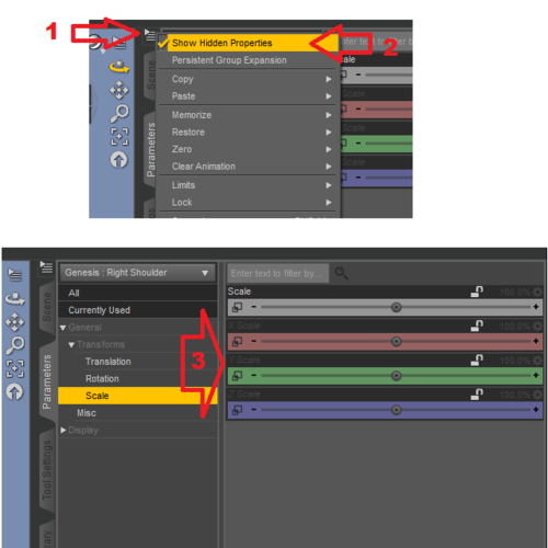

    Some of that can be done by scaling, though in DS you will need to right-click on the Parameters pane's tab or click the menu button in the top corner and select Show Hidden properties from the menu to get the axis scale controls, or with magnets/DForms, or even with built-in morphs for some figures and scaling options.
    Mostly, the scale happens in all direactions, while it's desirable to have in a particular direction, though we are glad atleast there is a possibility of dynamic Bone scaling in DAZ.

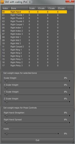

    The road ahead is starting to clear up now. I'm working on a number of proof-of-concept scripts, to see what can be done and learn how to do it.
    Just packed up the first one and i proudly called it "SnS_PoC_01" (Squash'n'Stretch Proof of Concept 01 :P)
    The script demonstrates that you can set up a chain of weight mapped scale transforms and combine these with existing Pose Controls (also weight mapped). The entire chain can then be controlled by a single slider.
    More mature versions of the script will need an option to save and share these presets. I also think it would be real nice if i could add an option to generate Pose Controls for the chosen settings.
    If you want to give it a try, you can download the script here.
    You must have a Genesis-figure in your scene when you start the script. It only targets the right hand, so zoom in on that before running the script.
    The next test will probably be on ease-in-ease-out or anticipation. Looking forward to your opinions/feedback...

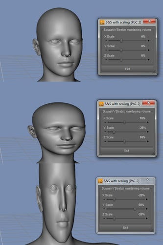

    1) Let's move on with the 1st Step. Allow the Neck to be "Elongated" and the face to be "Enalarged". That will help us create SNS manually.
    Remember we must not forget one basic principle. We must maintain the VOLUME. That means if the Neck stretches in one direction, it will get narrower. It can not expand in all direction. THE TOTAL VOLUME OF THE SNSed BODY OR BODY PART MUST REMAIN OR APPEAR TO REMAIN SAME.
    2) Let's attempt B in the same manner, work incrementally to begin with. Allow the user to stretch the Head in Y axis without increasing the size in other AXIS. If the volume is maintained, when the user tries to stretch/scale the head bone, the head in Y axis or upward, the head will get thinner and if downward, the head will Squash but will become fatter.
    In this case the head becomes a Primitive 3D object and we can use a Deformer to Stretch the head Upward or downward while maintaining the relative positions of eyes, nose and lips etc.
    VOLUME : Think of a balloon filled with water. If you press on one side, it will inflate on the other side, but the total volume will remain same.

    At this moment we must just focus on to the "Scaling of any Bone in a user specified direction" . That means if I select the chest bone in the scene, the script must allow me to scale that bone in any direction I like. Let us try this UNIVERSAL SCRIPT for scaling of any selected bone. First single bone then we can work with multiple selected bones.
    DAZ allows dynamic scaling of bones. But sometimes it scales in all direction.
    "I want it to scale as per my choice of axis ".

  • BlackFeather1973BlackFeather1973 Posts: 739
    The script already does that and a lot more, with the grouping, weightmapping and inclusion of PoseControls. Granted, it only did it for the right hand but it was just a proof of concept. Making it that way allows me to only focus on what i need to know/learn and thus make progress faster. Writing actual functional scripts is not even on the radar in this stage, that would cost me too much time.
    Scaling of a single/multiple selected bones is already standard functionality in Daz Studio. For most bones you'll only see a general scale slider in the parameters tab. The separate x, y and z-scales are usually hidden, but you can make them show up.

  • digitalcraftdigitalcraft Posts: 57
    Thanks for the indicator to the Scaling Property. I had missed that.
    You take your own time doing the script right.
    Second experiment : when scaling on one axis, the other two get scaled in the opposite direction. The adjustment values are calculated on the size of the bounding box, but are still a bit crude. Might try a few other methods to calculate adjustments.
    This technique might work for subtle SnS and on simple objects, but to be really usable it should be supported by morphs/dformers.
    Try if you like, script here. This is just a small testscript and only affects the head of a Genesis-figure (Genesis needs to be in your scene when starting the script).
    Even though the results might not look great on a Genesis head, we now know that the principle can be scripted.
