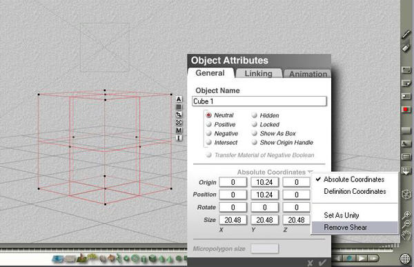

    For objects which distort when re-sizing after placement there is the "remove shear" option. See screen shot.
    Cheers
    GG

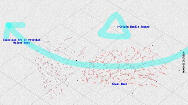

    In this case I am using "sock" from "PileofClothes" by mostdigitalcreations/Adam Twaites. It is listed separately from the other items, so I imported into DAZ, then sent to Bryce. That works ;-) It appears to be a single mesh, in the Bryce list, not a group.
    It was extremely difficult to find the origin handle looking for the green square-I had clicked on the 'show origin handle'. Had to enlarge the object until I could see the green square. I found I could drag the square around, but it did not seem to influence the rotation.
    This object can be moved by dragging and without shearing. It's weirdness is in the rotation.
    attached are the screen shot of the object in wire mode and a quick render of the object.

    Yep, that looks about right - Any rotation of an object will be centered on the origin.
    Tips: You can't change the origin handle color, but you can change the background color. On the extreme right of the interface, find the 'Background Paper' tool and change it to Black. The Origin should stand out pretty well then.
    To move the Origin handle quickly to roughly the center of the sock, try this:
    1. On your main alphanumeric keyboard (not the number pad) hit the number 2. This switches your view to orthographic overhead: you're looking down on your scene. If you're too close to the object use cntl/cmd - to zoom out, cntl/cmd + to zoom in.
    2. Locate the origin handle. Click on it and drag it to the position you regard as 'center' for the sock.
    3. On your main alphanumeric keyboard (not the number pad) hit the number 3. Now you're in right orthographic view. Reposition the origin again.
    4. On your main alphanumeric keyboard (not the number pad) hit the number 4. Now you're in front on orthographic view. Reposition the origin again.
    Now you have an origin that is centered for your object.
    Hit the ` key (left of '1' on the alphanumeric keyboard) to return to Director view.
