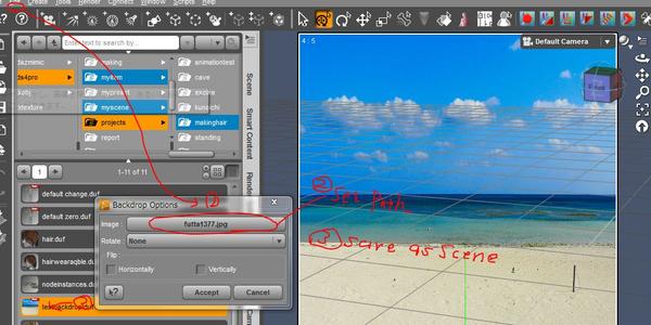

mm,, you use background picture as backdrop ?
About backdrop,, you simply download each pictures,
anywhere you want in your pc,
and you can use it as backdrop ,by top menu> Edit> back drop,,
then set the path of the pciture you downloaded.
Once save the scene, it can record the buckdrop path to the image.

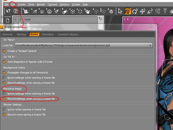

(if you "checked off" the setting of preference, you need to check on again, like my pic)
Edit>preferences or short cut key "F2"

then about backdrop,, it is like a decoration which stuck on frame of view. and renderd picture.
it just follow your view movements. it never change,, even though you change view (camera1 camera2,
or Perspective view)
ofcourse you can set backdrop on every scene..

and if you set your camera aspect frame, 3 :4, in Render Setting,
you may need to resize your pic to fit the aspect frame.
by Gimp etc,, cut or crop,, the part you want to use as backdrop, which can keep the aspect. 3:4
without it,, the pic stretch or shrink to fit the aspect .frame.
then apply backdrop. it become "background" of the scene. (picture).
