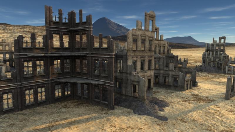

    I don't do it that way because of the scene size... as you have found out..
    Rather, I start a new empty scene 800 x 450 then I use the desert prop in the Carrara Objects folder tab... arrange it to suit my needs..
    in this example I just did, I dropped in a prop 'After the War' onto the desert object... took all of two minutes to set up and render.. this is how I do it... others will have their own way of doing it.
