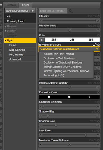

    Sorry, I can:
    If you have an UberEnvironment 2 light, select it and look under the parameter tab, you can set render options.
    The lower on the list, the slower is a rule of thumb
    432 x 629 - 49K
    Bounce GI is slower than an overweight sloth with a backpack full of lead bricks.

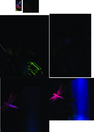

    Unfortunately, it rendered. All I can say is OH YUCK.
    The cyclorama, which was barely showing in the background (think dark forest) is showing quite a bit. The waterfall, which I had used a blue spotlight to get just the right effect, is a brighter blue. The lights look like they are not being used at all, all characters are in the dark. (The distant light, the spot lights on certain plants, nada.) And her hands look cartoonish orange. The spotlight on a bug is ultra bright. So why did two spotlights go brighter, the rest not show up at all, and the distant light go poof? Same settings as I gave you.

    The forums images are darkening- sorry you can't see the first two sets. But you can see the dragonfly/waterfall one.
  • JaderailJaderail Posts: 0
    This is going to be a problem for all people that View your images. Your Monitor is NOT calibrated to the DEFAULT settings. The Image UPLOAD'ed is set to what ALL users will see because the image is shown without any of your Brightness setting's or other adjustments. You need to do a FULL Monitor Calibration and then your Images will look the same on your Monitor and the Forums. If you do not do your renders on a Fully calibrated monitor others will never see on their screens the same image that you do.
    Your personal Settings (monitor) are not saved in the Renders.
    Are you using a skydome/enclosed environment?
    If so, under the Parameters for it, are Cast Shadows on or off...
    If they are on, then the distant light is 'outside' the 'box' and the shadow of the 'box' is blocking the light. The spotlights would be 'inside' so their light would be unaffected...also, in essence, making them 'brighter', as they are now the only light sources, so relatively, they are the brightest things present.
  • NovicaNovica Posts: 23,925
