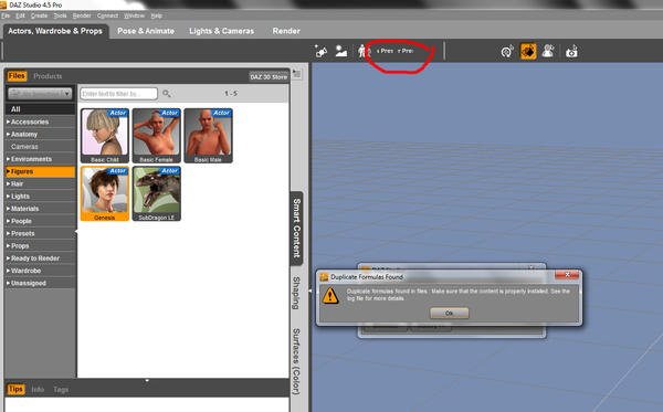

When loading a basic Genesis figure I am getting this. Any ideas how to fix it? The figure does load, I am just concerned there's something wrong.
Also, what's up with the toolbar (materials preset and character preset). The icons seem to be missing!

  • TotteTotte Posts: 15,402
    If you get it loading Genesis I suspect you either have an old Genesis Essentials, and old M5 Axel or a third party morph kit.
    The Duplicate ID is due to a bug in an older DS 4.0 when exporting files that then manifested in DS 4.5 It's basically harmless, but you should update the products causing it (downloading updates) or use the script by Richard found here: http://www.daz3d.com/forums/discussion/740/ to remove the duplicate IDs in clothing items.

  • Richard HaseltineRichard Haseltine Posts: 112,335
    My script is for Duplicate IDs, this is the older Duplicate Formulas issue. It could be that you have two sets of \Data\DAZ 3D\Genesis\Base files in your content libraries, or it could be that you have old, unupdated versions of some of the original morph sets. The FAQ, linked below, lists the affected sets - if you have the Genesis Expressions you need to uninstall the original version, then for all that you have reset your order, download the newer files, and install.

    Also, what’s up with the toolbar (materials preset and character preset). The icons seem to be missing!
    Which toolbars? Or do you mean one of the panes, that should be showing content?

    I mean this
    Ah, I missed that. Try switching to a different interface style (Window>Style>Select Style...), and if they are OK there then try switching back to the original style (assuming you want to).
  • SertorialSertorial Posts: 962
    Fixed it. Thanks!

    I am still getting this duplicate loading error whenever I load a Genesis figure. It's really annoying!
    This is the relevant bit from my log file, can anyone interpret it for me?
    Loading Startup Scene : C:/Users/Administrator/Documents/DAZ 3D/Studio/My Library/People/Genesis/Genesis.duf
    *** Scene Cleared ***
    WARNING: fileinput\dzassetdaz.cpp(5136): Duplicate formula found linking Value & CTRLFlirtingMasculineR in /data/DAZ 3D/Genesis/Base/Morphs/DAZ 3D/Expressions/CTRLFlirtingMasculineR.dsf.
    WARNING: fileinput\dzassetdaz.cpp(5136): Duplicate formula found linking Value & CTRLFlirtingMasculineL in /data/DAZ 3D/Genesis/Base/Morphs/DAZ 3D/Expressions/CTRLFlirtingMasculineL.dsf.
    File loaded in 0 min 49.3 sec.
    Loaded file: Genesis.duf
    Post edited by Sertorial on
    Reset your download of GenesisEvolutionExpressions
    I guess that you are not using the DAZ Install Manager, so to update your Genesis Evolution Expression Morphs you need to go to your itemized history in your account and find this product, reset the download and download it again.

    Duplicate ID is a problem with certain files created with an early version of DAZ Studio 4, in your case Genesis Evolution Expression Morphs.
    You need to download those again and install them again to replace the files with the DuplicateID with new files with that problem fixed.

    I'm not sure but the error said "Expressions" , FlirtLeft + FlirtRight.

    The error is caused by the OLDER Genesis files not being Uninstalled before the Newer Genesis Es files were installed. It can be fixed by going to the Data Folder and Deleting the Genesis folder and then Installing the NEW updated file again.
    EDIT: Data/DAZ3D/Genesis/Base , just remove the Base folder if you like but I would remove the Full Genesis folder.

    It should not. This will just remove all the old files left behind. But, and this is the kicker, if your saved figures call those older files then it could mess them up.
    EDIT: By the way Duplicate ID's are just info. They cause no issues in the program.
    In general new Genesis files overwrite the old - the only exceptions are the evolution expression set, which was free with the body and head morphs when they were first released. That set does need to be uninstalled, or the Expressions folder can be deleted from \Data\DAZ 3D\Genesis\Base\Morphs\DAZ3D folder - I wouldn't advise deleting the whole Genesis folder as it's easy to lose custom work or products you forget to reinstall.

    Yep, Richard is 100% on that. The Evolution Package came with the Expressions and have been Updated. The old set is causing the Dup ID errors.

    I'm sorry but the RED parts listed below say you DID have the Expressions installed at some time in the past. This is your LOG file is it not?
    They Came FREE for PC members who bought a set (I forget which one now) for Genesis when first released.

    ok, my mistake. So I need to reinstall Evolution Expression morphs
  • JaderailJaderail Posts: 0
    Yep that seems to be the issue. I'll ask Richard. He know much more about the Data folder than I do.
    Okay this seems to be the issue, DS has been updated and older files can cause the Duplicate ID error now. If you have the Original Expressions installer you can run it again and set it to make a uninstaller. Use the uninstaller to remove the files. Then go to your Itemized Order History and Reset your files and then Install them. That will fix your issue. The Updated files are Moved into a different folder and do not cause the ID error.
