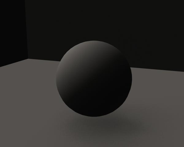

    Here are two renders...
    The first is UE2 Softbox 4x. It took 2 minutes 35 seconds to render.
    The second is envlight2, with the same map (OmSoftbox). It took 1 minute 30 seconds...almost a full minute less and that's 'low'. In more complex scenes the difference is greater. The envlight2 shader seems to be less impacted as the complexity increases.
    The render settings are the same...Pixel Samples 8; Max RTD 2; Shadow samples 32; Shading Rate 1.
    1000 x 800 - 232K
    1000 x 800 - 215K
