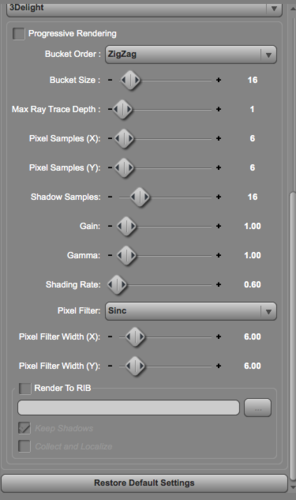

    I've tried to limit my render settings so it will render. I've rendered everything but the wall (6 people, the bar, the floor, the drink tables, bottles etc).
    I'm rendering the wall separately as I can't get it to render. I've attached my render settings for it.
    In regards to Imac's crawling at pc temperate, the main part of the scene had taken over 13 hours to do and was only at 60%. My computer crashed and I let it cool down. I put a fan behind the computer and it rendered it fully in 2 hours, 50 mins with no changes to render settings or the scene.
