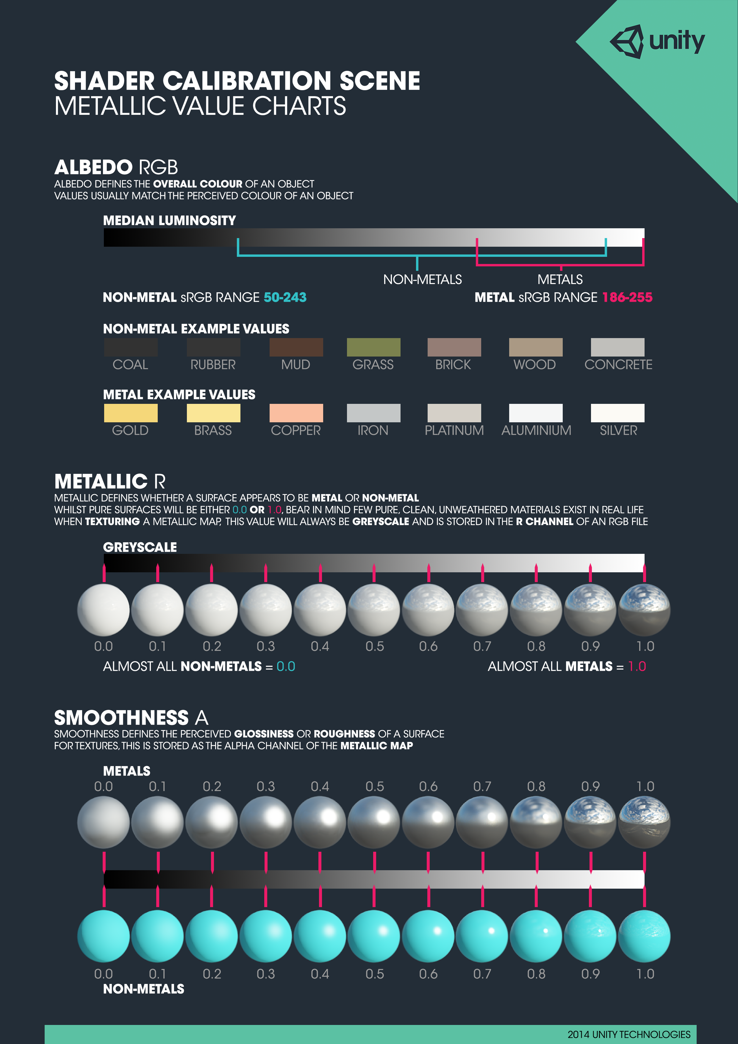

    And just as an example, this is an old chart from when PBR materials first started being a thing:
    Wish someone with access to a comprehensive electronic PBR dictionary would refine and publish it. While that chart is nice doing things like showing a color without it's RGB or other standardized written value isn't that helpful.
    Is there such a PBR dictionary for sale somewhere for the most common, say 10,000 materials?
    Post edited by nonesuch00 on
  • Nyghtfall3DNyghtfall3D Posts: 817
    Closest thing I've found is an sRGB chart on an Asian Twitter post.  When I entered the sRGB values on the right in the corresponding channels in the Base Color, I got surprisingly well-matched results.
