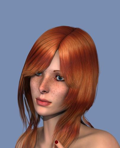

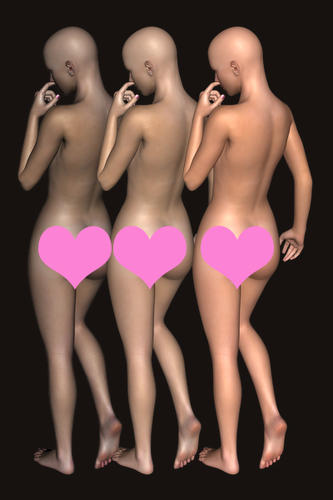

This render is with your defaults
same scene, with the above changes I suggested
