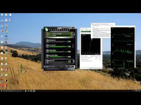

    MSI Afterburner will alow you to turn fans to 100% So before you start rendering Iray you need to fire up Afterburner and set fans to 100% then start render. Keep afterburner window open so you can keep track of card temps. If you live in hot climates you need to take side panel off pc and get a 110v fan that connects to wall socket and point it at your video card this should cool off your video card and prevent video card from burning up.
    Yep - I was going to advise Afterburner too ... I have it start when Windows starts. I use the progressive fan profiles so that the harder the GPU works, the harder the fans work.
  • BobvanBobvan Posts: 2,653
    I just installed it how do you set up the prog profile?
  • marblemarble Posts: 7,500
    I think I followed this ...

    In Afterburner, any system variable that it monitors can be placed in your system tray.
    If you look at the included screenshot, you can see what needs to be set in Afterburner.
    Settings -> Monitorint Tab -> Select the "Graph" that you would like to show -> at the botom set the "Show in tray icon" checkbox -> Click on the little color box to set a color for the text.
    I have mine monitoring the GPU temp (Green), CPU temp (Cyan), and GPU Memory usage (Magenta).
    1334 x 818 - 428K
