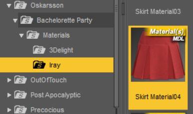

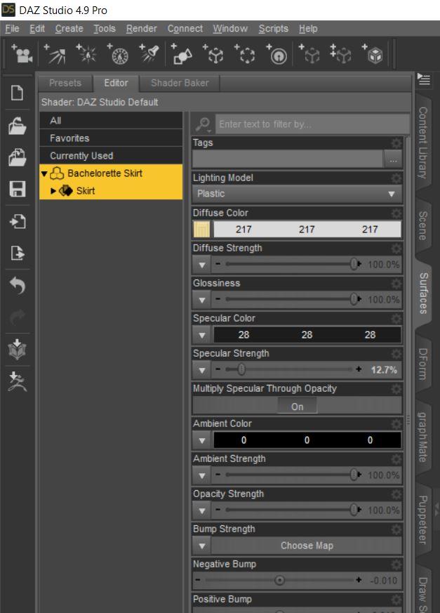

I bought the Oskarsson Bachelorette Outfit which comes with folders for 3DL and IRay materials. However, when I apply the IRay material and look in the Surfaces tab, it shows as DAZ Studio Default shader type. I concluded that the PA had somehow packaged the materials wrong, so that the IRay selctions pointed to the 3DL materials. So I logged a ticket.
Support have come back to me saying that I am mistaken and that DAZ Studio Defaults doesn't mean they are not IRay materials. They don't require IRay materials to use the IRay uber shader. Here's part of the response.
You mentioned that you are referencing the Surfaces tab to verify the materials of each clothing type. Are you concluding that the Iray materials were not installed correctly because they show the shader being listed as "DAZ Studio Defaults"? If so, while the shader listed is DAZ Studio Default, this does not always necessarily mean that these are 3Delgiht materials. While Iray materials are typically Uber shaders, we do not require this and some artists prefer to make their Iray materials with DAZ Studio Default shaders. Because of this, as well as comparing the file sizes of these two material options and rendering a few scenes, I do believe that the materials are correctly categorized.
So I am confused - as the support response says, I did think that "DAZ Studio Defaults" meant 3DL. Can anyone explain further? Does the Uber shader not define what is an IRay material?

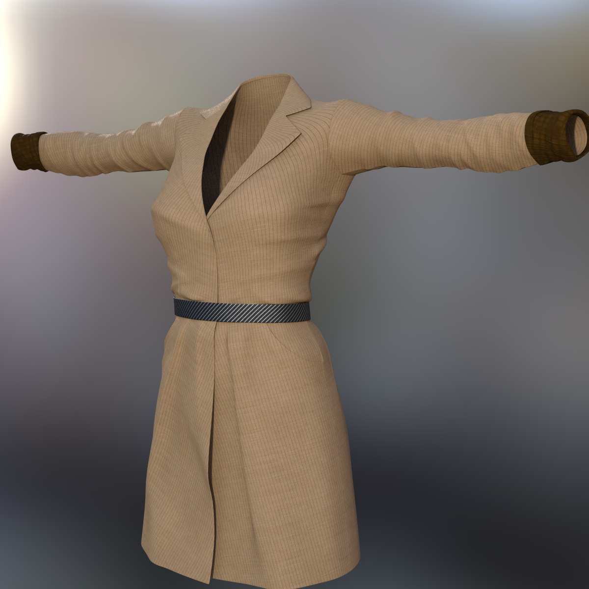

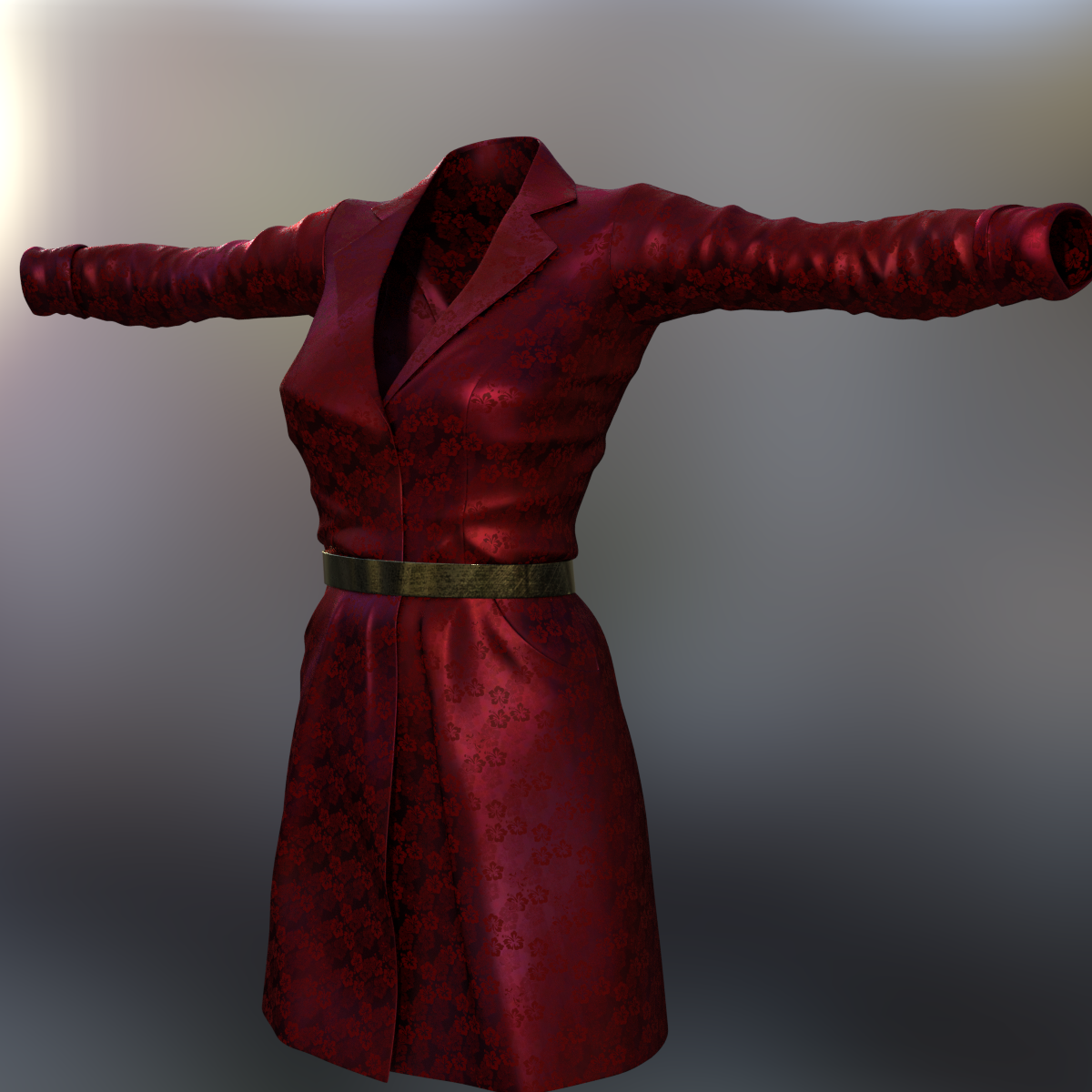

    I was under the impression that Studio auto converted 3DL materials when rendered under Iray. I just did a test that, to me, seems to confirm that thought. Here are 2 renders of Cara HD G2F. First render is with 3DL base mats but rendered in Iray. Second render uses the Daz Iray Uber shader, rendered in Iray. They look the same to me. What say you?
    EDIT: Apparently I was i a hurry and forgot to attach the images.
    I'm also going to agree w/ Tottallou AND L'Adair . I think it's disingenuous at best to advertise  that a 3DL material that "looks ok" in Iray is actually an Iray Material. To put identical materials in Iray and 3DL folders crosses the line to false advertising, lying or similar. It's the knid of think that makes me stop buying from a PA. Not to mention, what does that say to the PA's that actually create Iray shaders?
    I'm also going to respectfully disagee with "The Daz Default Shader is a 3Delight Shader. If the PA has adjusted its settings to give the intended results in Iray then that is an acceptable use - it's the results that matter, not the route taken." That may be acceptable to the poster (whom I respect), but it's not acceptable to me. I also don't believe that a 3DL shader can be adjusted to give the same results as Iray uinless it has all of the Iray parameters, (thus becoming an Iray shader).

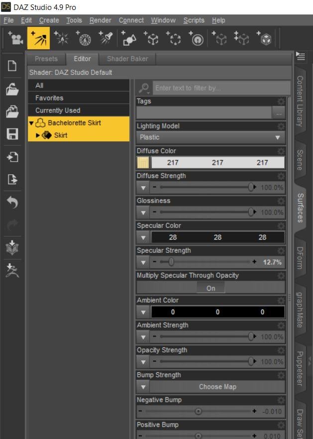

    Yet when I look at another product which has IRay MDL materials, the Surfaces Panel has IRAY Uber listed as the shader. This is why I'm a little confused.

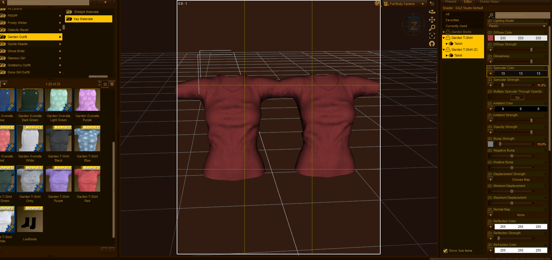

    Does the Iray MDL preset have actual Iray settings or even anything different to the ones that are in the 3DL folder?
    The product I have does not say MDL & the actual preset settings in both Iray & 3DL folders are identical-  It seems to work fine in both which as Richard said is what matters most but IMHO it should not say
    when really its 3DL mats that work in Iray

    I do not have the Bachelorette Outfit that Marble is using. I do, however, have another Oskarsson product which states Iray Materials, has separate icons for Iray Materials, but in fact uses 3DL materials.
    To test if there was anything different between the materials from one shader to the other, I put two identical products in the scene. In the case, the European Loafers from the European Clothes for Genesis 3 Male(s). I specifically applied the 3DL shaders to one pair and the Iray shaders to the other by clicking on the material icons.
    The loafers have 7 material zones. In the Surface->Editor, I selected each zone for both loafers, one at a time, and looked at the various parameters for that zone. In all seven zones, the parameters were identical. There wasn't a single <?> showing for anything. I did the same thing with the pants and the sweater with the same results. For the colors I checked, the shaders were identical whether the material was applied as a 3DL or Iray shader.
