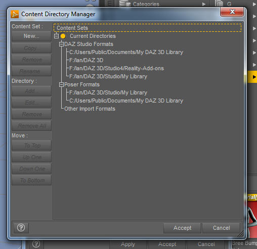

    I'm having the same problem with V4/M4.
    Using the Dim, I've installed V4 base/V4 base powerloader and V4 base StudioCF files. V4 appears in my content directory fine, however when you try and load her into a scene you get the error message The "Victoria 4" support folder could not be found.
    If you click OK the powerloader window appears, but all tabs are empty.
    The same applies to M4.
    In my case my Daz installl is to my C drive, but my content is mapped to F.

    Well, so far it looks correct, but what is installed to the Support folder?
    I have a Base.DSA and a Base.DSX file for V4, among others, is that what you have?
  • fixmypcmikefixmypcmike Posts: 19,702
    Can you go to Edit > Preferences > Content Library > Content Directory Manager, expand the "DS format" and "Poser Format" sections, and post a screenshot?
  • BunnyTVSBunnyTVS Posts: 13
    edited February 2013
    I have the dsa and dsx files for M4/V4 base and M4/V4 base studioCF.
    Here's my Content manager mapping.
    Edit: I appear to be able to load files not related to V4/M4 fine.
    508 x 493 - 150K
    Post edited by BunnyTVS on
    That is your problem.
    You have the DAZ Studio Formats path entered correctly, but the Poser Formats one needs F:/Ian/DAZ 3D as well, the same as the DS Formats one. You don;t need the entries for 'My DAZ 3D Library' in either of the formats since you don;t have anything installed there, or do you?
    Thanks, that got it. Yeah I got a prompt recommending I add the 'My Daz 3D Library' to the Content manager for some reason, but it's just a sub folder of my main content, so I'll delete them and see how it goes.
    V4 is loading fine now.
