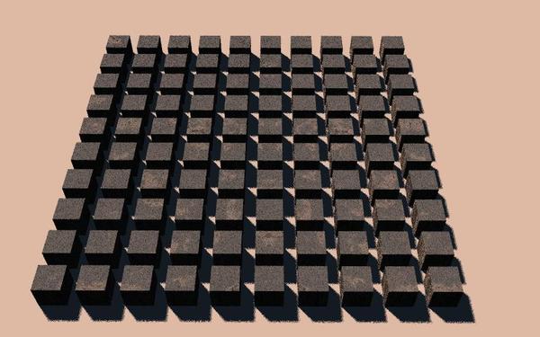

  • Dave SavageDave Savage Posts: 2,433
    edited February 2013
    Use the 'Multi-Replicate' function.
    Create your first block (eg: 10x10x10) and place it top left of where your grid will be created.
    Go to Multi-Replicate (Under the 'Edit' menu)
    Set quantity to 9 and Offset on Z axis to 15 (this will leave 5 units between each block)
    Click the tick.
    A row of block will be created evenly spaced out. Select the row (it's handy to group them too)
    Go back to Multi-Replicate.
    Quantity should still say 9, if not, re-type 9 in that box.
    Set offset on X axis to 15.
    Click the tick.
    You've now got a grid of 10x10 blocks with a space of 5 between them.
    Hope this helps.
    800 x 500 - 63K

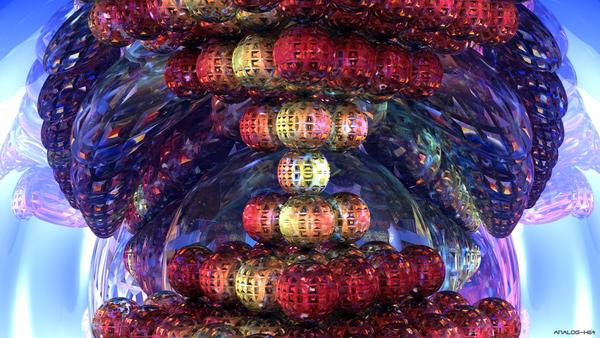

  • Analog-X64Analog-X64 Posts: 110
    Here is the first result of what I've learned from creating grids from this thread thanks to TheSavage64's assistance.
    1920 x 1080 - 497K

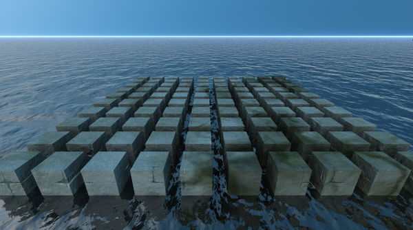

    It does indeed, thank you :)
    Rendered with TA lighting at 64RPP.
    757 x 422 - 488K
