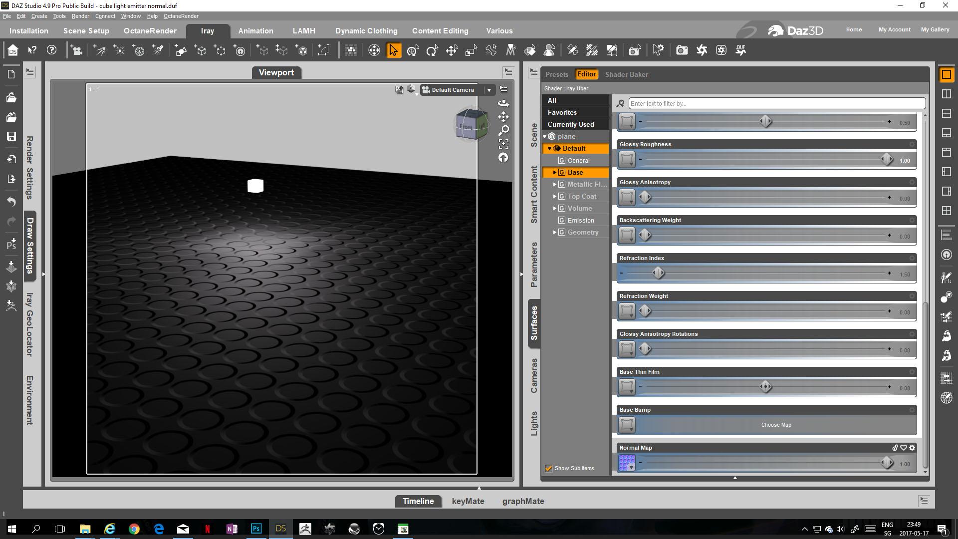

If you are interested in accurate light and shadows on all surfaces it is important to use either
- actual high resolution geometry with modeled detail
- high resolution hd morphs with render subdivision levels 3 or 4
- displacement maps
Bump and normal maps will not cast accurate shadows and destory the illusion if you are aiming for photorealism.
This does not only matter for textures on clothes but especially for indoor environments.
This comparison focuses only on the differences between normal, bump and displacement maps.
Test scene with bump maps:
Test Scene with Normal Maps:
Test Scene with Displacement Maps
-> In this case the bump map was used as displacement map.
Min Displacement was set to 0.
Observable Result:
The normal maps yield the worst possible result with shadows completly ignoring the light source.
The bump maps at least give some kind of illusion that the light source has an effect but light strenght is not accurate.
-> The only physical correct light and shadow simulation is achieved by using displacement maps.
Test this yourselves with attached scene files and maps:
- The bump and normal maps are attached as well so you can try this out yourselves.
The maps were created with a filter I created from scratch in Filter Forge.
-> I have the right to share the maps.
- The DAZ Studio 4.9 scene file is attached as well. You will need to manually link the maps in the surface settings.

  • Oso3DOso3D Posts: 15,129
    edited May 2017
    I think the problem is that you need to flip the Y on your Normals, actually.
    (I don't know why, there are details about it, but basically Iray handles Normals differently than a number of other programs)
    Post edited by Oso3D on

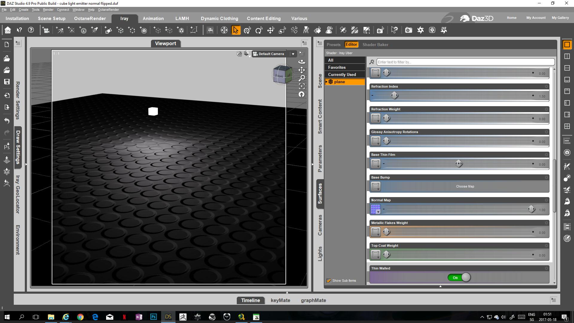

  • kitakoredazkitakoredaz Posts: 3,526
    edited May 2017
    I like those test, but I feel your normal is not adjusted for daz studio cordinate correctly,  is not it? wink  I feel you need to inverse color component.of R,G
    because your normal seems for direct X verison. (then left upper become dark, ) it show reverse  concavity and convexity in daz studio
    Though I know, displacement should work best (but we need many sub-D, and it use memory)
    test with this if you need (I tweak component R G, in gimp 2.9)

  • linvanchenelinvanchene Posts: 1,386
    edited May 2017
     @ timmins.william
    Thank you! I just used the default normal map export settings  in Filter Forge and did not think about that.
    There is even a (very old) discussion about this on filter forge:
    https://www.filterforge.com/forum/read.php?FID=9&TID=1476
    Need to look into that and figure out if there was any development on that front.
    So far I have not found any more advanced normal map settings inside Filter Forge.
    @ kitakoredaz
    Thank you a lot for providing the updated file!
    Tested again with this:
    Test scene with normal maps flipped (file provided by kitakoredaz)
    edited May 2017
    unfortunately I do not have filter forge, but I remember quite a few user recommend it, I think there whould be correct way (option) to generate normal for DAZ iray normal cordinate.
     my assanption,  ds iray normal map is tangent-space normal, then  R = U (x) axis, G =V (y) axis,   (UV world), then B should correspond to The surface normal direciton(z) , and represent ,each pixel normal direction as vector...
    but the difficulity is, the way ,apply RGB value to these 3 demension, is different about each aprication and shader.I memorized before for my usage, , which guide about normal map for game  modder , it was  like that (though the author not confrim if it is right for current version)
    Max(+X,-Y,+Z)   Maya(+X,+Y,+Z)ZBrush(-X,+Y,+Z)Blender 2.4x(-X,-Y,+Z)Blender 2.57 later:(+X,+Y,+Z)
    ・xNormal(+X,+Y,+Z)・CrazyBump(+X,+Y,+Z)
    anfotrunately, I do not know, ds iray how represent RGB,, then I usually first  use Blender or Xnormal cordinate. then if it not work,, invert R,G or both,  when  I need. but hope to know, DS iray cordinate clear. (those things need to be dsicribed as daz official document,,indecision)
    AwsomeBump (unfortunately, it seems stop up-date) , can generate each PBR map from diffuse, and can convert from hegith to normal etc,, (but I can not strongly recommend awsom bump,,because of the UI, though I like this tool)
    https://github.com/kmkolasinski/AwesomeBump/releases
    And jusf for excuse, I know,  when someone introduce these "easy one click convert and generate tool",,there should be strict answer,
     "No,, it can not generate true effective normal map, you need to bake from real deformed poligon then generate normal to low poligon,)etc,,,
    Yes I know such thingssad,  just hope to make normak, from simple diffuse  or height map,,when I get free those,, ,,or I need to model or sculpt everytime just to make ground normal, though I made those with blender, and bake.when I need, like that (someone if need ,use these normal map free as you like, it is simple sculpt and bake normal in blender by my self,  I inverse height map then use as roughness too, for qucik ground. sorry,,but sorry those are 2k map ^^;)
