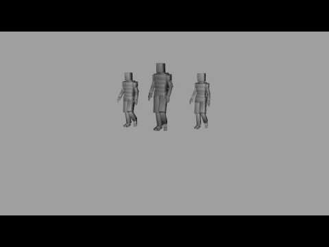

    I ran one more test, and - sure enough - the morphs applied to the shorter figure seem to be causing my "out of step" issue.
    The sample scene shows (from left 2 right): G3M scaled to 86%, G3M at 102%, and to the far right G3M with morphs making the figure shorter.
    Bummer..
    Now I have to figure out how to work around this.

  • OK, it looks like using the youth morph is causing the problems.
    The "Massive" morph only slightly increases the height of G3M, but with 80% youth morph the difference in translation between characters is very apparent.
    Same like my video a couple of posts up. The odd thing is that the bones on import into DS are fine, but saving and then applying the animation as a pose preset shows the problem.

  • DrGonzo62DrGonzo62 Posts: 406
    edited September 2017
    pdr0 said:
    Can you be more specific about which "youth" morph ? eg. Which package is it from ?
    Is it a custom morph or does it use "scale" ? If it uses "scale" somewhere on one of the nodes, then did you try one of the workarounds?
    I'm using the Growing Up for Genesis 3 Male & Female morphs.
    And yes, there is scaling going on. I will try to use one of the workarounds you suggested. You've obviously spent some time on this issue, not an easy subject matter.
    On a side note - you've probably ran into sliding feet issue when importing a MoBu anim back into DS.
    I tried using the mscasual AutoLimp 2015 script on the feet, but it gave me less then satisfying results. Weird foot twisting and such.
    Have you figured out how to get foot placement as solid in DS as it was in MoBu?
    Post edited by DrGonzo62 on
  • pdr0pdr0 Posts: 204
    Very likely that's the reason - scaling inheritance interpretation rules in DS
    No I haven't. If the animation is ok in mobu - then it's ok in DS too. Motion transfers perfectly using FBX, merged as a pose preset on the target Daz model
    I usually keep the fbx mesh to compare, and you can see they overlap in terms of motion perfectly . That is "minus" the subd differences on the DS model, but you can toggle to base resolution, but that usually won't affect "motion" characteristics unless there are massive subd modelling differences, or very fine motions like the difference between a base finger and a subd'd finger. Or if you footwear that change size slightly when subd'd , that might show slight offset from the ground. But nothing as big as footsliding, assuming there was none in mobu
    In MoBu I just tried copying the hip rotation and translation keys to the root node instead, and I delete the TR keys on the hip.
    While the anim still played fine in MoBu, the imported anim in DS was a mess. Not sure what I'm missing here.
    Sliding feet - I have a couple of idle animations and I used parent/child constrains on the feet in MoBu to keep the feet from moving too much.
    And although I plotted everything down in MoBu (do you plot with Unroll or Gimbal Killer btw..?) and disabled the constrains, the characters feet in DS are not
    nearly as solidly planted as they are in MoBu.
    I'll try to get an anim up to illustrate.
    And a quick edit here:
    When I just scale a character in DS, then I don't have any issues with offset translations between different characters when re-importing back into DS.
    But when there is a morph that is changing the scale (like the Growing Up morphs)  that is when I have problems. Not sure if that has come across.
  • RobotHeadArt in another thread posted that DAZ's Iray shaders work in Houdini's Mantra engine as it is PBR. Houdini will work with Octane and Redshift, too.
    https://www.daz3d.com/forums/discussion/comment/2802921/#Comment_2802919
    Also RobotHeadArt started a thread on how to import DAZ characters into Houdini.
    https://www.daz3d.com/forums/discussion/196556/daz-studio-and-houdini-go-procedural
    Thanks Kevin - I'll definitely check this out!
    T only. Keep the R on the hip
    I typically use unroll .
    If the plotted skeleton is "solid" in mobu, it should be solid in daz. Look to other reasons for the mismatch, such as forgetting to unlock nodes/ rotation limits off or the scaling inheritance issue
    But your workaround was ERC freeze in scale case, did you do the same thing in the morph case with all affected parameters that are linked to "scale" ?
    Thanks pdr0,
    I'll try that out tomorrow. Makes sense that the scaling issue would show up on translations.
    So far I have used ERC freeze only on the scale parameter of a character, so I'll' see if I need to include additional parameters.
    It's weird that the imported bones fbx looks fine in DS, but that applying that pose preset to a character doesn't work.
    Thanks for your feedback though!  :)
    DrGonzo62 said:
    Thanks pdr0,
    But I have cases where the imported fbx bones are way, way off , and yet the end result is a perfect match . I would not make any judgements based on the appearance of the viewport from the "broken" fbx importer; the only thing that works is transferring motion keys
  • Yes - that did it. Incredible!
    Moving the T keys to the root instead got rid of the translation mismatches. Fantastic.
    Thanks pdr0!
