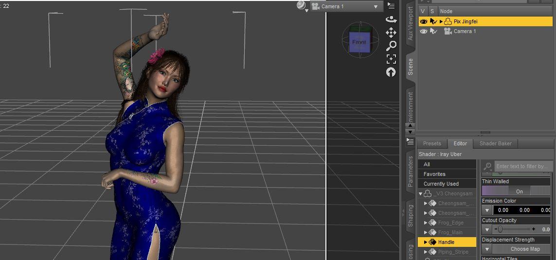

    1.) Sometimes there are dress handles that can be turned off under the dress itself, but if you can't turn them off without turning off the outfit, look at the Surfaces tab. There will be a surface called "handles". Change the opacity (or cutout opacity) to 0 and they should disappear. I have found this on a couple of different Generation 3 items, including the V3 Cheongsam dress:
    2.) If fitting the hair is not working, try putting figure into T pose, then positioning hair the way you want it and then parenting to head. The hair should follow the figure in poses but not drop down or look strange. I often do this with hairs that are not designed for the figure I'm using it on. Sometimes I use G3F hair on V3, like in this picture. Hair is parented, not fitted. Works best if figure starts in T-pose, since hair starts in T-pose too. (Both Gen 3 figures here have parented hair.)
