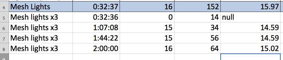

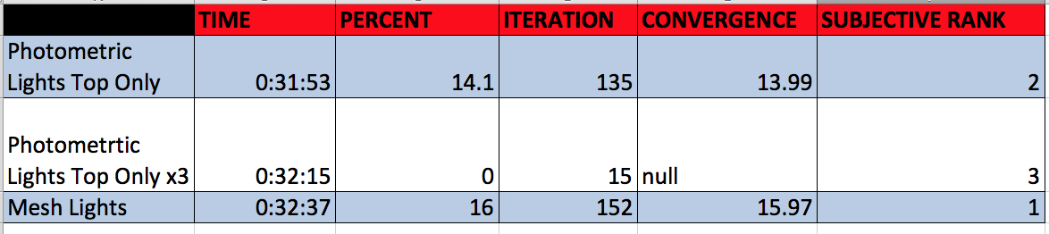

  • ScavengerScavenger Posts: 2,677
    edited April 2017
    Hmm.. Did 3 tests, not of the broken vs single lights, but to see speed differences between the mesh lights and the point lights (and a 3x size of the point light that I'd shrink in post).
    With this test, the mesh lights, not the photometric is about 10% quicker.
    (I have no idea if this test is meaningful...if the progression is linear, if it changes over a greater amount of time...)
    EDIT: Did a series of tests with Mesh lights at 3x the size, to see if i could track how these progress.

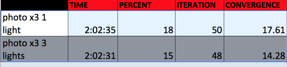

    edited April 2017
    Well.. finding all sorts of data that I don't know what all it means, but to answer my original question,  I did a 3x size render with the photometric light, then split it into 3, and did it again..the single light had slightly more iterations  and convergence in a full 2 hour run.
