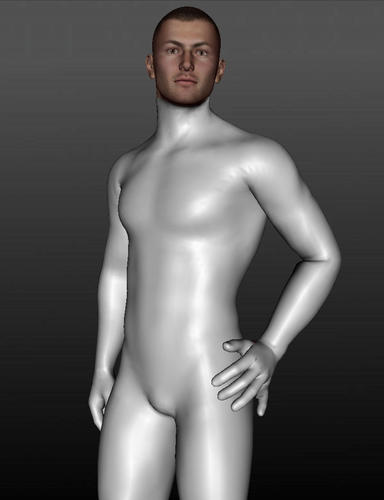

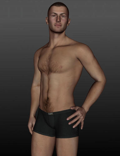

Here's some viewport renders, I quickly took awhile ago. You can definitely see there's quite a bit difference in the collars and elbows.

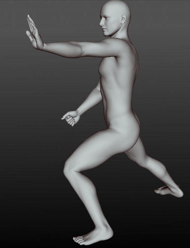

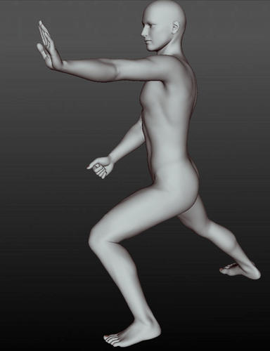

From M4's included poses - M4 009. First is default M4, below BB M4. You can see differences on the thighs/knees as well. The bodysuit is still set at Bulk 0.1 and still conforms to the figure.

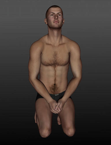

Pose 005. I remove the skin textures so the changes stand out a bit.
