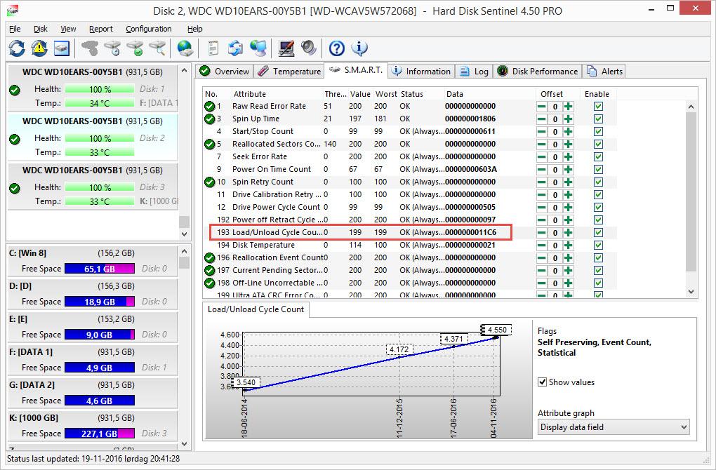

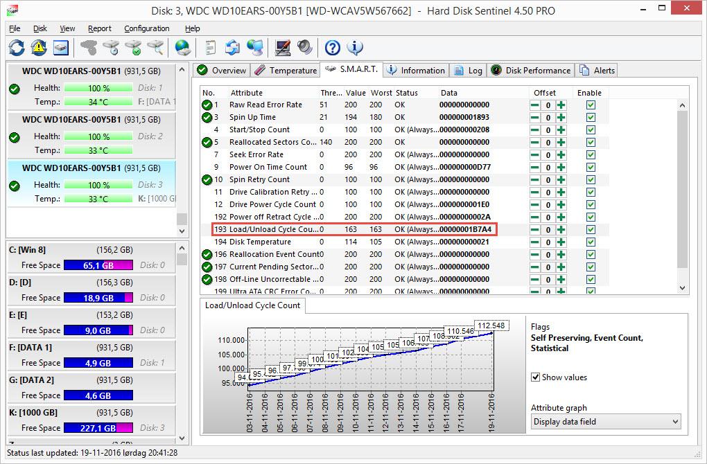

    A lot of WDs drives including some of the newer Red NAS drives are suffering from the infamous Load/Unload Cycle (head parking every few seconds ) problem,  meaning that the drives can hit the max number of Load/Unload Cycles (usually 2-600.000 depending on the drive type) in a few months if the drive is running constantly. They have a tool where you can change the setting, I always check the drives and change the setting if it's too low. There's been a lot of talk about it (just search on "WD head parking", 591.000 hits on google) but WD seem to keep quiet about it. Here's one of the more informative threads:
    https://community.netgear.com/t5/ReadyNAS-Hardware-Compatibility/WD-Red-drives-park-their-heads-like-WD-Green-drives/td-p/869565
    Here's an example of two drives of the same type I've purchased, the oldest one has the problem (which I discovered quite late because I forgot to check the drive), while the newer one doesn't. With the one with the problem the cycle count has increased from 94.000 to 112.000 in just 16 days, with the other only from 3.540 to 4.550 in 2+ years.
    1020 x 670 - 333K
    1020 x 670 - 351K
