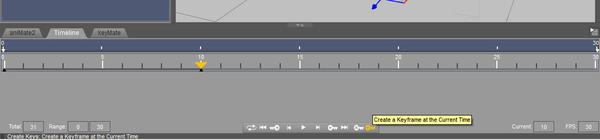

I don;t know what you mean by 'Save' a keyframe. To Create a Keyframe, you use the keyframe button as shown below. Is that what you mean? You can see a black dot below the yellow triangle, that means that there is a keyframe there.

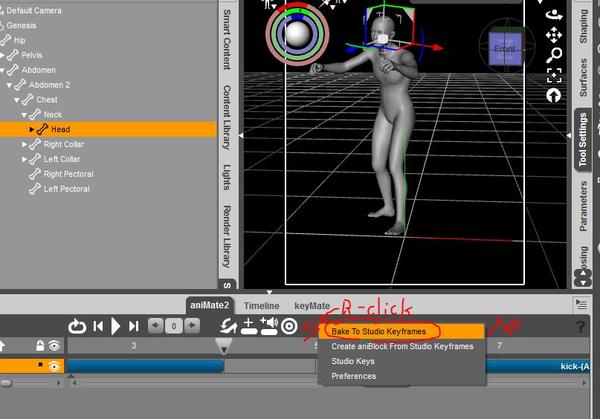

but you can bake animate timeline keys (which now you setted two or three bolocks ) on to the daz timeline.
after that, you can edit the non poze frames, in daz timeline. it may work.

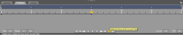

There is a vast differenvce between deleting all animation, and deleting keyframes. To delete keyframes, select each keyframe in turn, and use the Delete Keyframe option as shown below.
