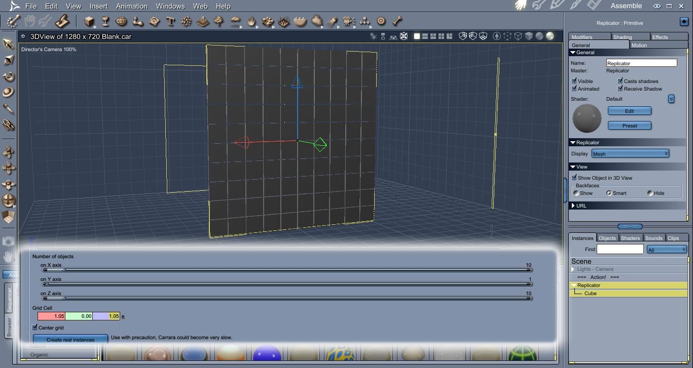

    It's much easier than that. Like I said in my first post. Here are some screen shots to help.
    Edit: Note that the camera view doesn't change in the three screen shots to demonstrate the size of the replicated structure
    First of all, select the item to be replicated and switch to the motion tab to get the exact dimensions. We use that to fill out the Grid Sizes in the Replicator.
    Here I have a cube 1' x 1' in x and z, I don't care about y because I want that to be exactly the same. In my new replicator, I set my x grid to 1.05', y to 0.0' and z to 1.05' and I'll have a gap between each piece. I am replicating 10 along x and 10 along z   I have a small screen capture of the Grid settings from the replicator over the sequencer
    Here is what happens when I change x and z to 0.5' : The pieces are overlapping each other 0.5'
    and here is x and z set to 0.2', and also highlights the dimensions in the Motion Tab
    The grid size lets us overlap or replicated item or put gaps in them and we can even set up random differences for a human feel to the construction.
