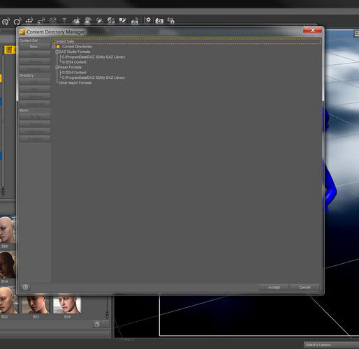

    this is my content directories now. Is sthere s step by step of how to move stuff around in categories? I think I have really messed it up now as the folders from adam's folder structure are now integrated into my categories but not all of them ...only the ones I moved stuff to from unassigned category. I just don't get it...sorry

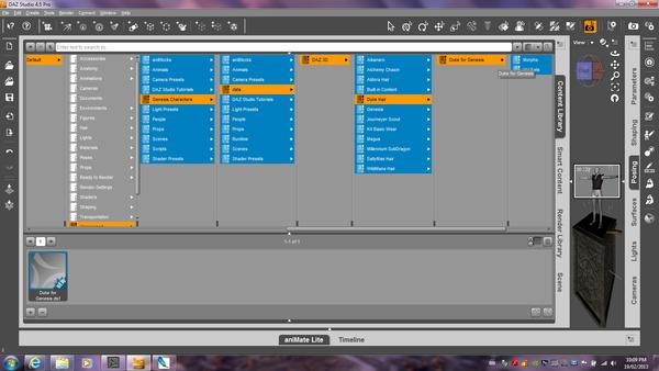

  • KharmaKharma Posts: 3,214
    mike this is the data folder I am refering to...how and where can I catagorize the morphs and uv folders in here?

  • fixmypcmikefixmypcmike Posts: 19,742
    The problem is that you have nested content folders, "E:\3D Content" and "E:\3D Content\Genesis Characters". Nested content folders will cause many problems, one of which is having special folders displayed that shouldn't be visible.

  • adamr001adamr001 Posts: 1,322
    Okay, so the problem you're seeing Kharma, as MIke pointed out is the nested folders.
    Let me see if I can help.
    Here's the basic problem:
    You have "E:/3D Content" defined as a DAZ Studio Format directory.
    This causes DAZ Studio to search, recursively, every folder underneath it for content. Including the folder E:/3D Content/Genesis Characters/
    Thus when you ALSO add E:/3D Content/Genesis Characters/ you end up confusing DS and it's showing you things it shouldn't.
    I'm thinking that your current issue is this:
    You have some content (perhaps Genesis Starter Essentials, perhaps more than that) installed to E:/3D Content/
    Then later you installed other content to E:/3D Content/Genesis Characters
    Is that the case?
    If so, the correct solution is to move everything inside of E:/3D Content/Genesis Characters to E:/3D Content/

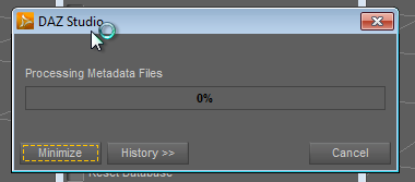

    You'll probably need to reset your database and then reimport metadata to get things straightened out.
    If that's not the case, will you try and explain for us what is in E:/3D Content and E:/3D Content/Genesis Characters and why they are separate in your mind?
    Okay, great, this is salvageable. :)
    You should not have E:/3D Content/ mapped at all.
    You should have E:/3D Content/Genesis Characters mapped as both Studio Format and Poser Format.
    If you have E:/3D Content/Hair it too should be mapped as both Studio Format and Poser Format.
    Etc.
    Much like my setup.
    312 x 570 - 11K

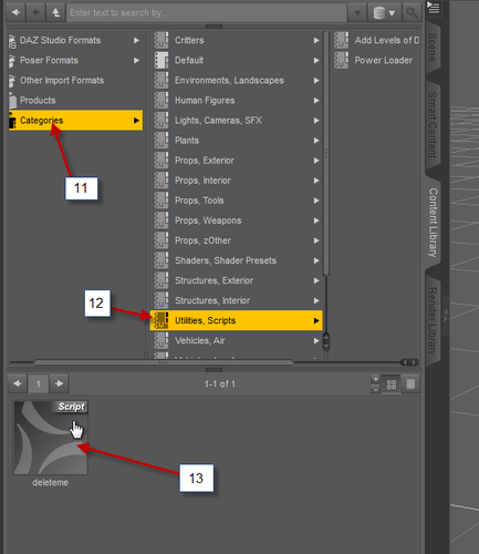

    To backup: ON the Content Library tab, go to the Context Menu at the top, select "Content DB Maintenance", select "Export User Data". This will export all *custom* work in vairous "UserData_XX.dsx" files where "XX" is some number, like "UserData_1.dsx" they will be sequential. These files will be stored in the runtime\support folder of the FIRST listed DAZ Format directory.
    Copy them to someplace safe. If you ever need to restore you can just re-import metadata with these files in the first defined directory's runtime/support sub-folder and all your custom categorization will come back.

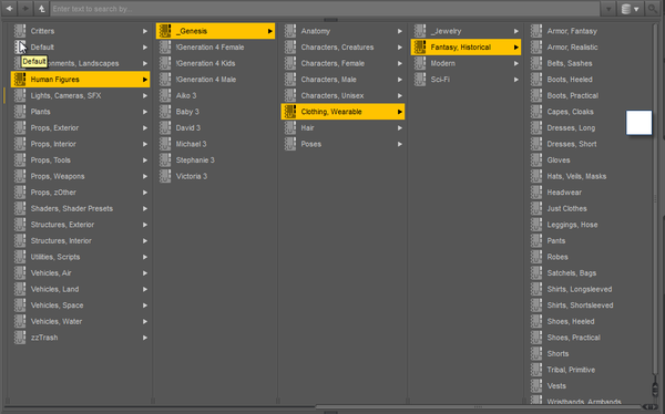

    On finding parts of outfit: The way *I* work, every outfit gets one "Main" category for everything and then it's pieces go in the other spots. So Magus for instance, in my mind it's not any kind of armor and it's not a dress, so I put the entirety of it under "Just Clothes" but I *also* categorize the leggings, shorts, staff, earrings, etc. in individual areas so I can find them when I'm kitbashing. For instance, I've got a skirt on Genesis from, oh, the Day Dreamer skirt and the idea in my head is to layer something under... I go to Pants, Tight Long and low and behold, there are the Magus Leggings. :)

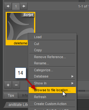

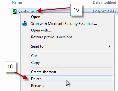

    Re: Default Categories... You can't delete stuff from the default, but you CAN categorize from there and duplicate the files into another category.
