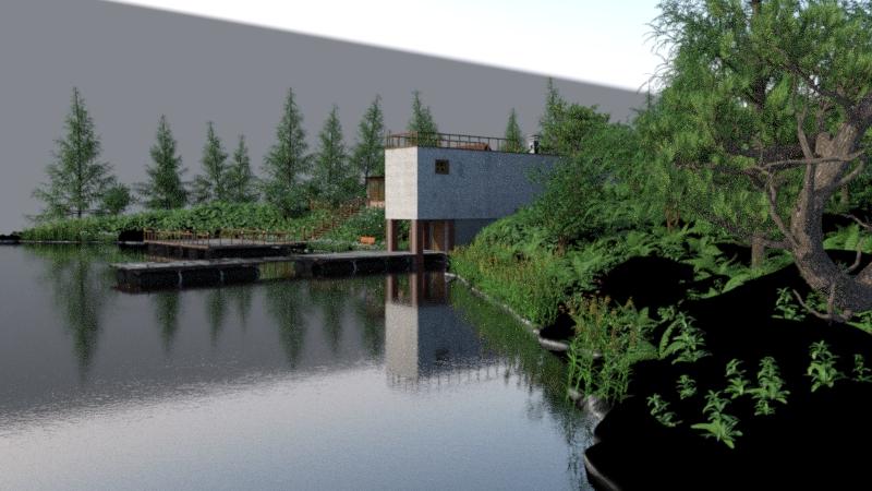

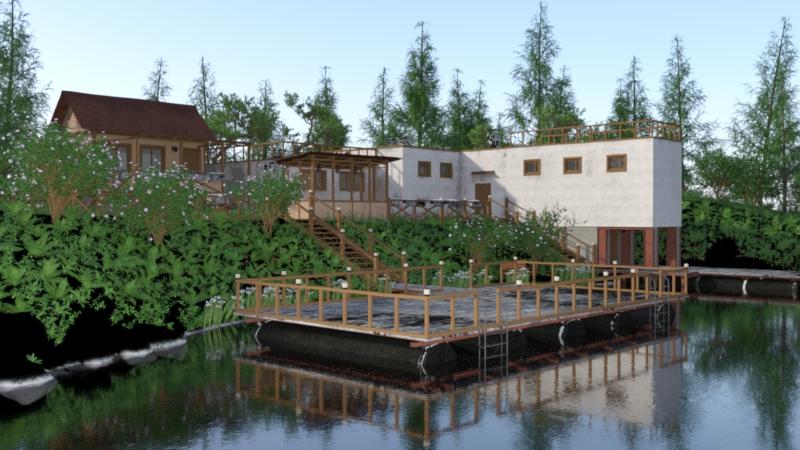

I'm trying to render "On The Shore" ( http://www.daz3d.com/on-the-shore ) but it looks as if something's wrong. First, there's no sky (but maybe it's not included, I don't know), second, all the stones render black. Otherwise everything seems to be OK.
I load the complete scene, then I add the included Cameras and Iray Light and Render presets. I can see that the Iray render settings changes, and the render looks different than if rendering with the DS default settings, so the render settings seem to be applied.
Anyone else who have tried to render this and made it work?
Here's one of the DAZ Promos plus what I get when I render it:
800 x 450 - 84K
800 x 450 - 66K

    Thanks. It looks to me though as if your daylight render also have the "black stones" problem, though it's not so easy to see from that angle. You could try camera 18 which I used, to check.

    Are you renredering in Iray? Be sure " Draw Dome" is turned on and that it is properly positioned. I had to turn the dome on and now have a render from camera 18 cooking. It shows the stones properly and I'll add it in a few minutes.

  • Out of the box but with "Draw Dome" turned on. Stopped at 85% completion.

    I'm rendering in Iray yes. I did try to turn the dome on after my last post but it was malpositioned (Y:90 Z:-15 - the light preset does that) and I didn't see any clouds like on the promos after resetting it. And stones still black. Here's a quick one to show how it looks.

    Here's another camera view with the dome on and reset. Sky OK as such but no clouds. But maybe they're not included?
    Stones still black. I wonder if it can be the NVidia drivers. I have a 1070, maybe it's the new 10xx drivers?

    Actually it's not just the stones that are black, it's also the ground.
  • To be more exact; I loaded the preload set, then the Iray light and render settings, then the cameras. After that I went to the Render settings, turned the dome on, and adjusted it. The result was the render I posted above - No black rocks.
