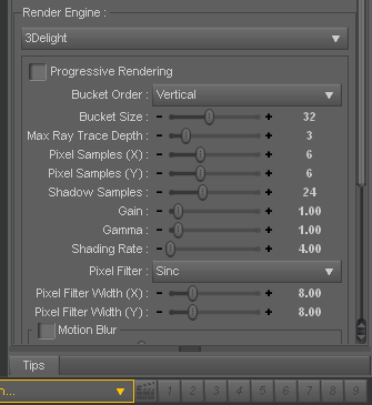

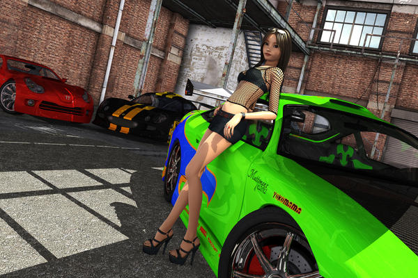

  • adamr001adamr001 Posts: 1,322

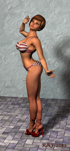

    DS is quite capable of producing high quality renders. In some cases, many things are easier in one application or the other.
    This, for instance, I couldn't do in Poser, but it took me about 20 minutes, including rendering to do in DS. Genesis, with standard character and texture applied, Tatiana Hair, SY Classy Swimsuit, some sandals and a couple of mesh lights I created.
    Finished Rendering
    Total Rendering Time: 11 minutes 5.5 seconds
    2000 x 2000 - 355K

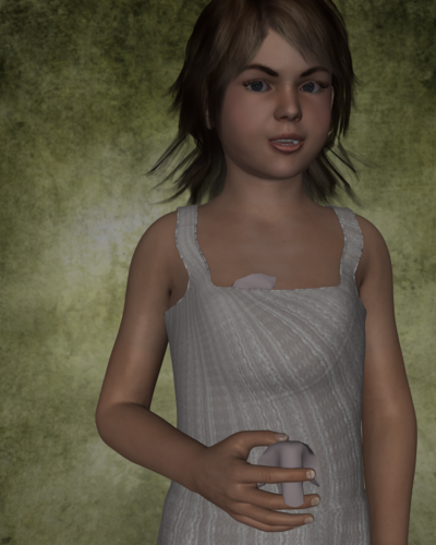

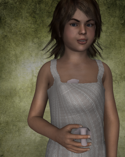

    out of the box, I find Poser and DAZ Stuidio Rendering to be fairly even, the only thing giving Poser a slight edge out of the box is the fact it has a manual. Other than that you're still doing google and forum searches to gleam nuggets of wisdom on how to improve your renders.
    DAZ I think gets the edge once you get used to it and start digging under the hood.

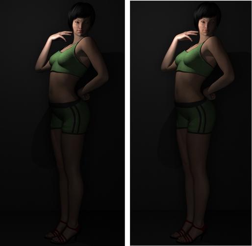

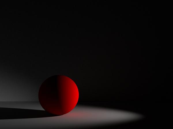

    Photo-realism is forever the uphill struggle of the aspiring artist. The fact is there's no easy way to get to that level of skill, it simply comes with constantly challenging yourself to improve. The level of realism you can get out of an image is easily proportional to how much work you're prepared to put into it. Everything from the pose to setting up the background plays a part, but lighting is key.
    Lighting really can make or break a scene. Compare and contrast these two images. One is done using four lights, and the other is using a single shader light. All of the lighting is vanilla installation lighting which anyone can do after installing the program. The character is not.
    210 x 699 - 122K
    210 x 699 - 132K

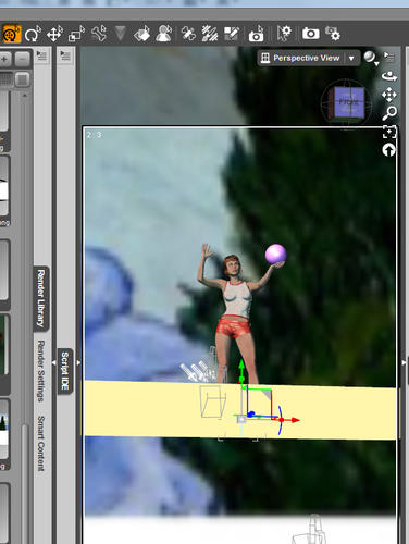

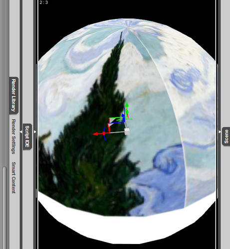

  • prixatprixat Posts: 1,627
    edited January 2013
    There shouldn't be a problem getting images onto the UE sphere just for reflection.
    Get your cloud image to look something like this:
    ...the white part is below the horizon so I left it blank.
    the actual size is up to you it just has to be twice as wide as it is high.
    I spent no time on the seam and edges since they're out of shot.
    If you have to then in Photoshop its the usual 'Rectangular to Polar', do your stuff and back to 'Rectangular'.
    701 x 350 - 106K
    Post edited by prixat on
    Then put it in BOTH the diffuse and ambient channels of the sphere.
    you'll get this:
    601 x 800 - 104K
    595 x 645 - 87K
    edited January 2013
    The sand coloured plane is giving the orangey cast from below.
    400 x 600 - 63K

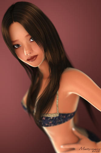

    Here's a little something I've been toying around with...
    I'll have to give it a shot with the IDL camera when I add shadows to it. Right now it's a single distant light and an environmental light shader (not originally a DS one...but the envlight2 shader packaged with 3Delight). The skin is UberSurface with most of the advanced features actually disabled...SSS IS on. The kicker is...this is rendered at a sahding rate of 4.0...and it took less than 10 minutes to render on my dual core/4 GB machine...at 800 x 1000....it was supposed to be a 'test' render before I turned on the shadows and dropped the shading rate...
    wow that looks great.

  • RarethRareth Posts: 1,462
    here are some results from rendering with IDL shader camera, and without IDL shader camera
    image on left is a regular default DAZ camera, image on right was done with the IDL shader camera
    785 x 764 - 61K
