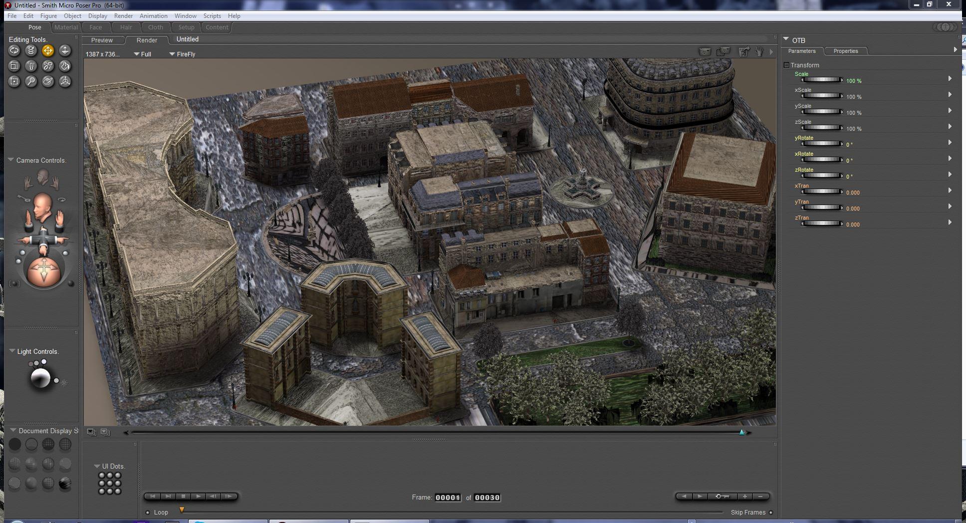

    What options are you using on the OBJ export? In modo, the one on the left has Collapse UV Tiles unchecked while the one on the right has it checked.
    1259 x 885 - 240K
