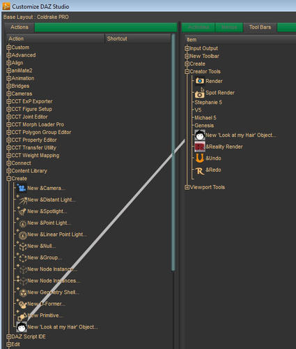

  • ColdrakeColdrake Posts: 236
    mathman said:
    I went to that dialog, there is a list of Actions a mile high. I went thru' all of what I thought might have been appropriate, but couldn't see anything that allows me to add new icons to my toolbar.
    Hi Mathman, you'll find it under "Create". Just click and drag the LAMB icon to the toolbar of your choice.
    Your icon will look a little different, I made a custom icon so it will show up better.
    Coldrake

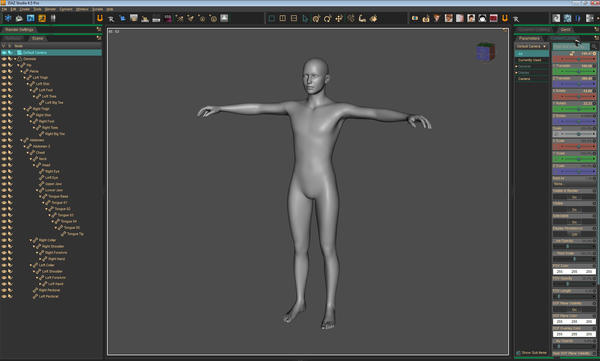

    mathman said:
    Take 2, I got it after all.
    Thanks !
    Excellent! Glad you got it working. I'm so used to using the same layout I sometimes forget there are others, I didn't think about things being in a different place. I use the Darkside Style customized to my workflow. I love that you can put pretty much anything in a toolbar. I have shaders, characters, cameras, whatever I use most frequently.
    Coldrake
    1919 x 1155 - 190K
