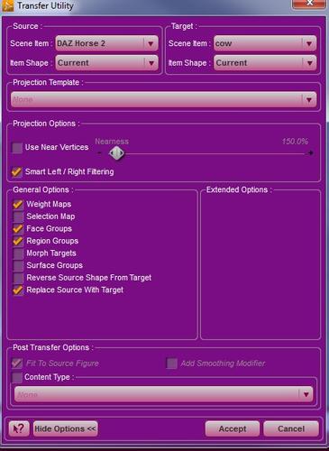

OK, doing something silly
using horse2 to add a skeleton to an imported cow obj using transfer tool
UDDERLY no idea what I am doing though
but
it works except for one big fail
the cow transforms back to its default import position and the bones end up outside the vertex model influencing the wrong bits of mesh
so before I can even consider wielding the weight brush I need to solve this.
I use Carrara where attaching skeleton is as simple as lining up bones then weightpainting, studio is foreign ground to me
I know you can group vertices and use figure set up tools but this seemed a simpler more Carrara like way to do it and almost works.
anyone?
(grr I might have to read Blondie999's book I bought and learn do it the PROPER way!!)

  • Richard HaseltineRichard Haseltine Posts: 111,929
    Size and position the cow, export that as an OBJ, import the new OBJ, run the Transfer utility - the TU works on the base mesh, not the current state.

    I made a bit of progress
    thinking outside the box I sent to Hexagon and transformed and rotated cow there sending back as new obj
    that attached to bones in place
    now weight brush here I come and make a dogs breakfast of it!!
    hey RH you got in before I could upload! thx anyway figured it out
