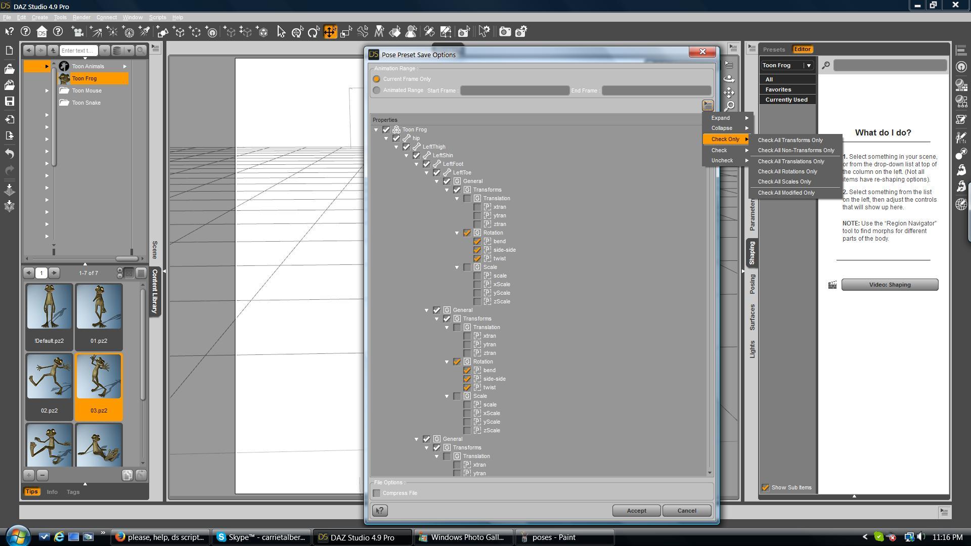

    Misty  are you using the check all thingy??

    checl all thingy is more than i want,
    ise being cautious dont want him to move from his spot when applying a pose, smiley

    Ahhh but if you look at the checky all thingy you have options of check all translation or rotations or scale if you click on ALL ROTATIONS only then your pose won't cause your figure to jump around it's how I save my poses ,and if you only want a partial it's a bit easier to go in and uncheck what you don't want to save.
