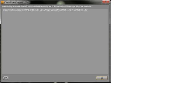

Hi,
Why am I getting this error when trying to create a Poser Companion File from a duf file ?
Any help appreciated.
thanks,
Andrew
1152 x 648 - 45K

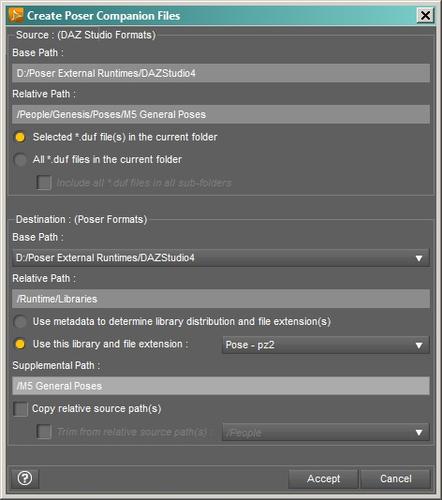

  • KeryaKerya Posts: 10,943
    I have exactly the same versions ... I am adding a screenshot of my settings.
    (as I don't use metadata, I don't rely on them for getting the correct library and extension)
    472 x 534 - 63K
