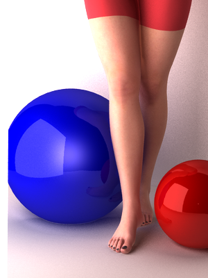

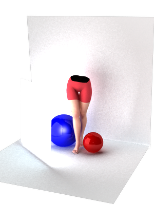

    to get the square arealight to show up on the spheres with this setup:
    300 x 400 - 115K
  • prixatprixat Posts: 1,630

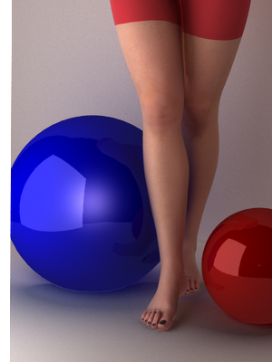

    I turned up the ambient from 0 to 100, leaving the intensity at 100.
    ...and got an image with 200% and some burnt out highlights:
    300 x 400 - 144K
    a couple of ways round it, I reduced the intensity to 0 and just relied on ambient.
    (or you could reduce the overall exposure, that's labeled 'Gain' in the render settings)
    So for now 'Ambient' gets a reprieve :lol:
    If anyone has a use for diffuse or opacity in an arealight I'd like to see it. :-)

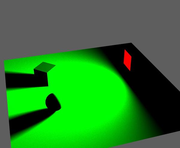

    Here's a simple test bed that shows it: a pure white plane, ball and cube, lit by a planar area light, emitting pure green light and having pure red ambient colour. If the two mixed, the scene should be lit in yellow - but it is not. Only the colour set on the light shader has any influence on the actually emitted light.
    1069 x 880 - 196K

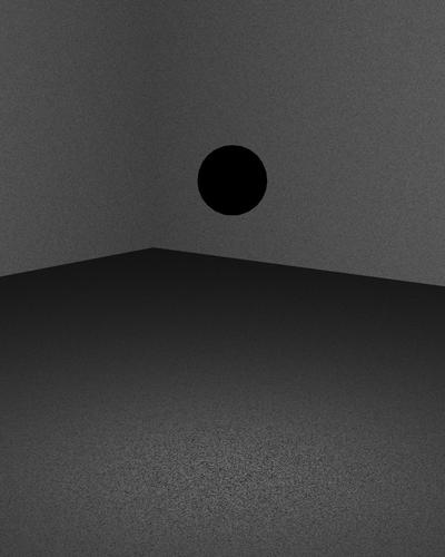

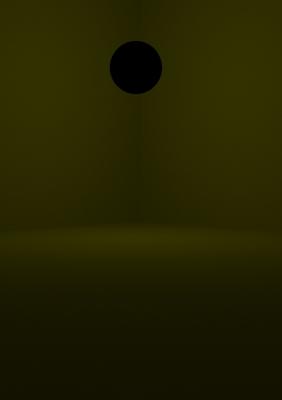

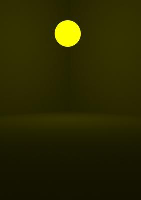

    I'll have to check, but I think that Opacity can be used to give an 'invisible' emitter...in other words set to 0 should turn off the visibility of the item without affecting it's light output.
    Yep, exactly what it does...
    Render 1 Sphere opacity is 100%
    Render 2 Sphere opacity is 0%
    Render 3 is using the 'eye' icon to turn off the sphere' visibility...
    All three are rendered with 'low quality' render settings for maximum speed...
    800 x 1000 - 13K
    800 x 1000 - 477K
    800 x 1000 - 472K
  • BejaymacBejaymac Posts: 2,019

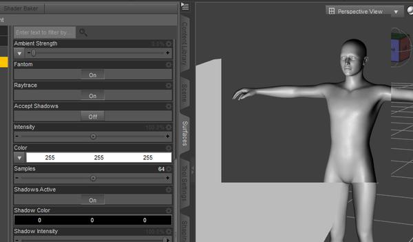

    There's an option in the Arealight shader called "Fantom", turn it "on" in the surfaces tab and you don't have to mess about with Opacity, the pic is a quick spot render showing the Area disc lighting up Genesis, as you can see fantom is on.

    Bejaymac said:
    Yes, Fantom works, too...but with the Opacity, you can still use maps to give a pattern to the emitter,,,just create a normal transmap and enable Ambient, with a bit of color and you have a shaped, glowing emitter...

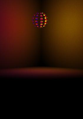

    While not quite the same, mesh lights/area lights are loads of fun. I once modeled a light bulb, down to a simple filament. Then used that in a flashlight, with a carefully modeled parabolic reflector. Then I rendered it in Lux, with an volume defined. The reflector was set to a mirror material, the filament was a mesh light and the bulb was a glass material...and when all was said and done, it looked great...but I didn't get a chance to save the final image, as my network went down. I should go back and render that one over again...I should have the scene file somewhere, I know I've got the models.
    I wonder what it would be like doing that in DS 4.5 with UA
    800 x 1000 - 63K

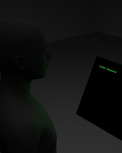

    Or something like this...
    Two area lights...one overhead and other is the 'screen' with an transmap and the ambient turned on...that's over top of a slightly large square primitive, with a slight amount of ambient strength (5%, I think) in the same green as the the light color.
    800 x 1000 - 236K
