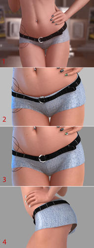

    Thanks for the hint on this function, I was not aware of it. But it is not as accurate as scaling would be and also has no use if you want to change the size of clothing. Like shortening a skirt or making a cape longer or shorter, if those items have no morphs for it. I consider scaling and for certain clothes translating of parts essential for achiving a look that I want and/or at least for the fine tuning. Here is a pic to make clearer what my problem is.
    In pic 1 you see a cut out of a render I did a while ago with DS4 Pro. The pants snug to the body, fit nice and tight as I wanted it too look. I achived this by simply scaling and translating the item and then mesh smoothing it.
    Pic 2 shows the same scene without any changes, rendered with DS 4.5 for this testing purpose. As you see the pants don´t scale, they keep their original shape, even though the scale values are intact in the parameter tab.
    Pic 3 shows the same scene again with the transfer morphs function you mentioned, looks better, but you see the difference. It still needs scaling for the fine tuning.
    Pic 4 shows the same scene from a different angle, to show that morph transfer can not do all the work on its own. You see the problem here, to fix that I would still need to scale and translate the item.
    I tried to unlock all nodes and rotation limits on the item and V4 but it makes no difference. The cloth always keeps it´s original shape.
