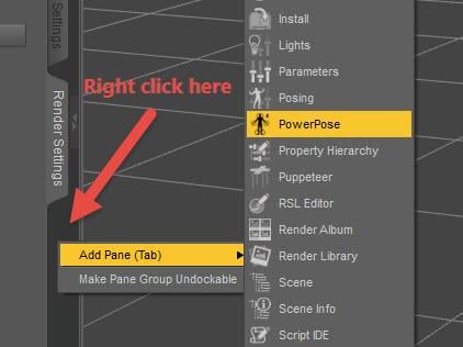

    Thanks! How do you get the pane to be added to the other tabs, like parameters instead of just floating?
  • TaozTaoz Posts: 10,384
    edited January 2017
    422 x 316 - 35K
    Post edited by Taoz on
  • rnollmanrnollman Posts: 310
    It works! Thanks.
