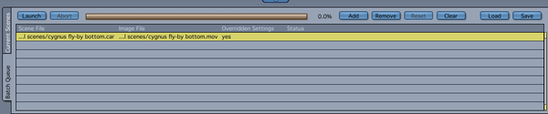

    Does this make sense for Batche Queue: file d'attente en lots?
    With a scene open, the bottom of your screen should look like it does in the first picture.If you click the tab, it will should look like the next picture, with all the options to select. You can set up a whole list of scenes to render and it will go through them all in order. What's nice, is that you can pause a render, even for a still image, so if the picture always crashes on a certain spot, pause the render before that point, quit Carrara, and maybe even reboot the computer, then open Carrara and resume the render. If it's a memory issue that could solve it. If it's a conflict with something in the scene, that could be a pointer of where to look.

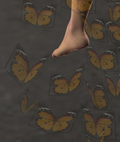

    I know English isn't your first language (sometimes it's not mine either ;-) ), but if I read what you wrote correctly, it sounds as if you had the replicator convert the replicated objects to real instances? This can be a big memory hog. Other issues could also be causing problems, like some light cone settings could be a problem. What are your light cone settings?

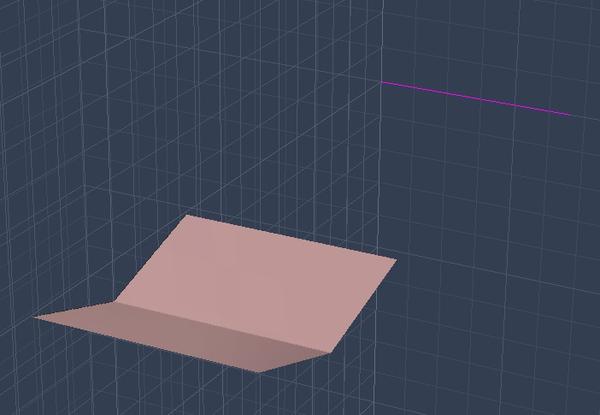

    convert the replicated objects to real instances : yes but it's a simple object (look images) and I think no much "polygons"

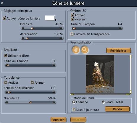

    What are your light cone settings? >screen capture

    Looks like you have very modest and reasonable settings for the light cone. I was afraid that everything would be turned all the way up and the light through transparency option would be checked. It's given me problems in the past, which is why it was on my mind.
    The butterflies look very low poly and probably wouldn't be an issue unless you had several thousand.
