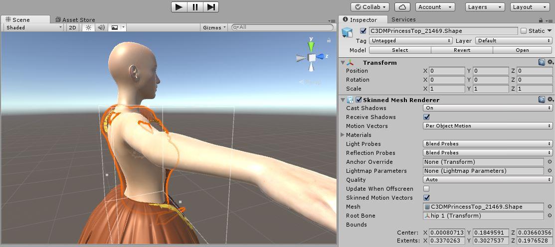

  • Maybe I needed to detail I'm really a noob. I was able to export a Gen3 + clothing to Unity and all appear to be fine. But I'm ignorant about the different animation systems: bones vs morphs. Understood DAZ uses morphs, Unity bones+skin weights. Easier path to animate?
    DS uses both bones (the joints) and morphs.

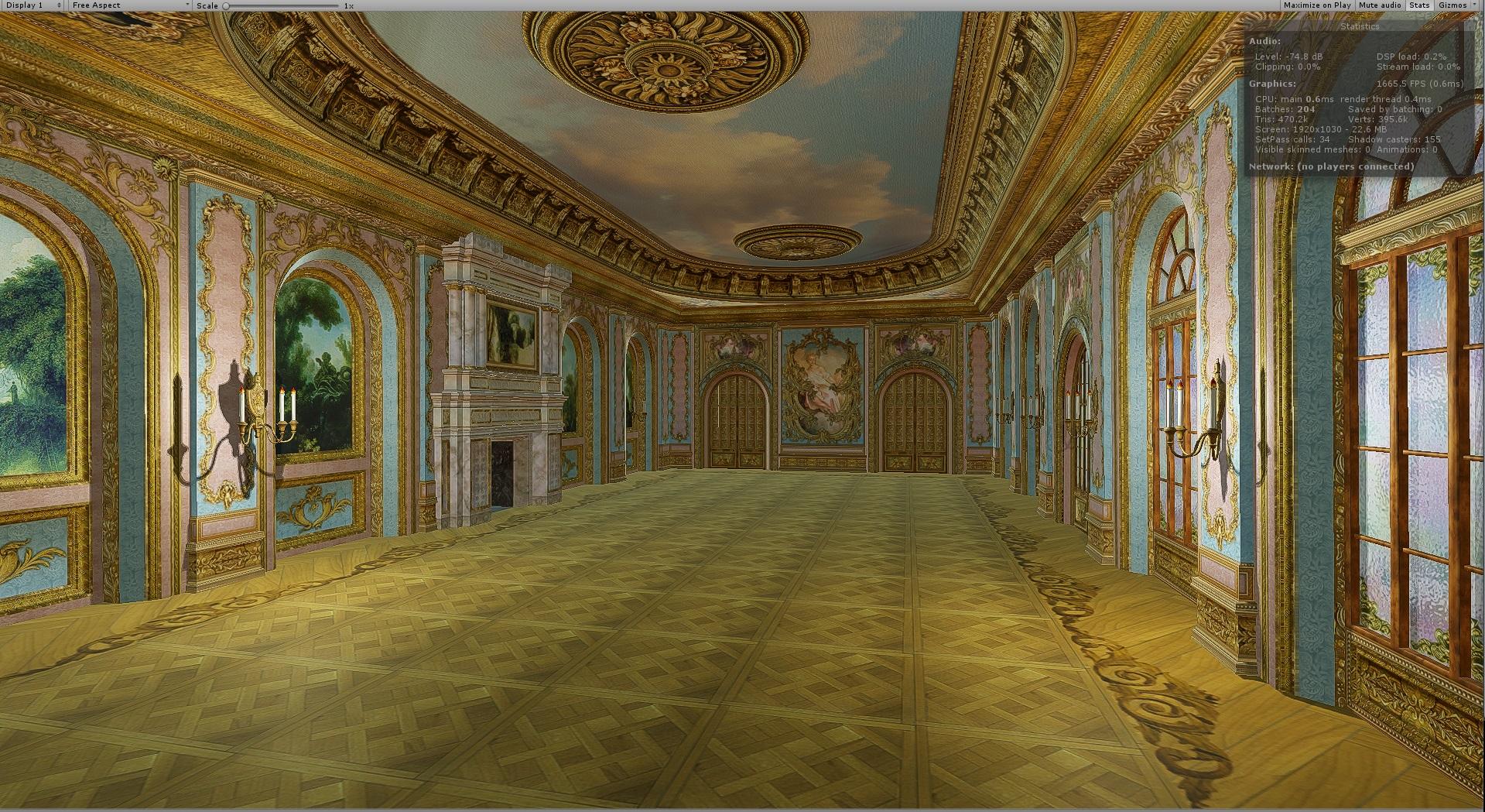

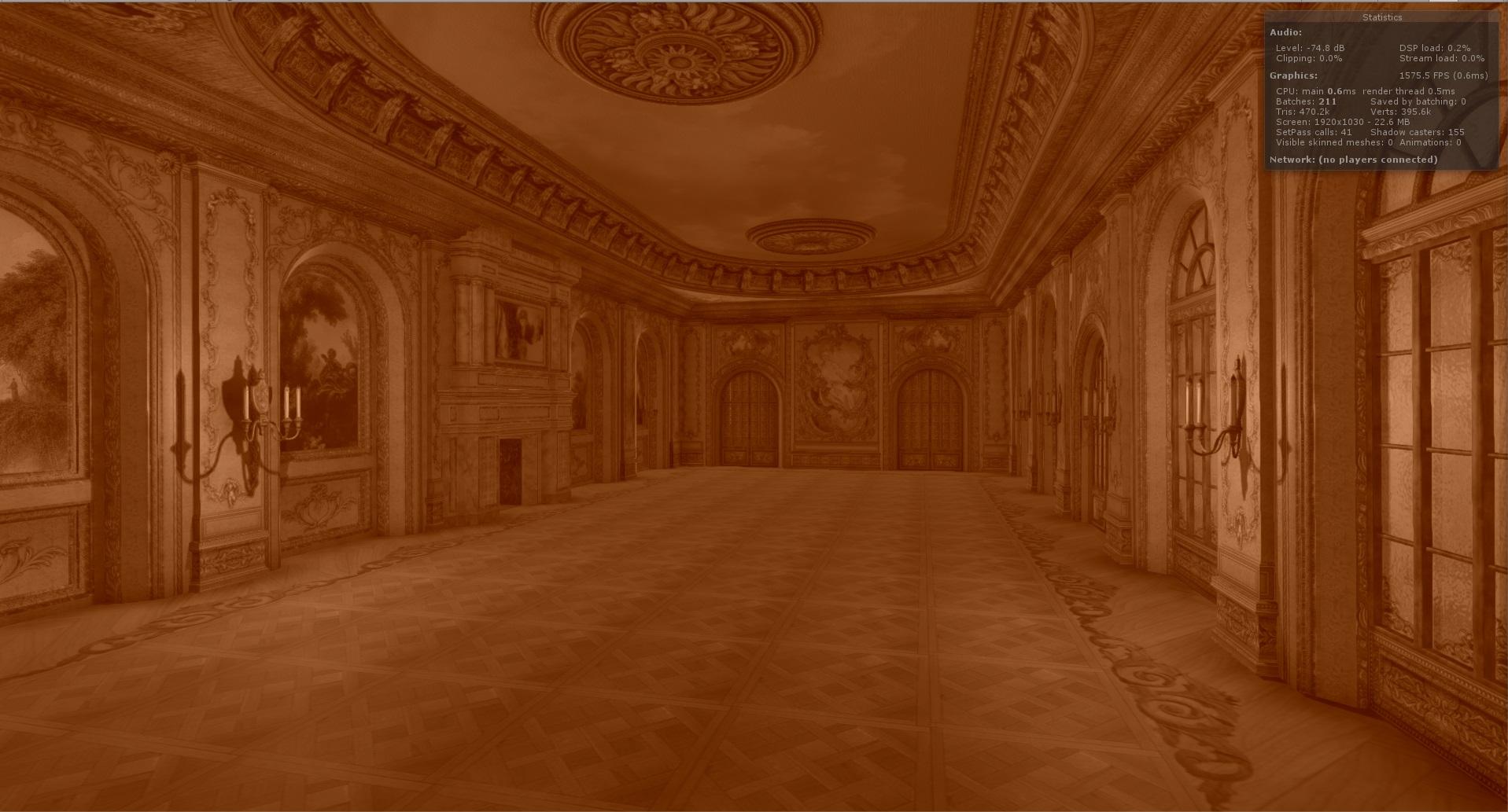

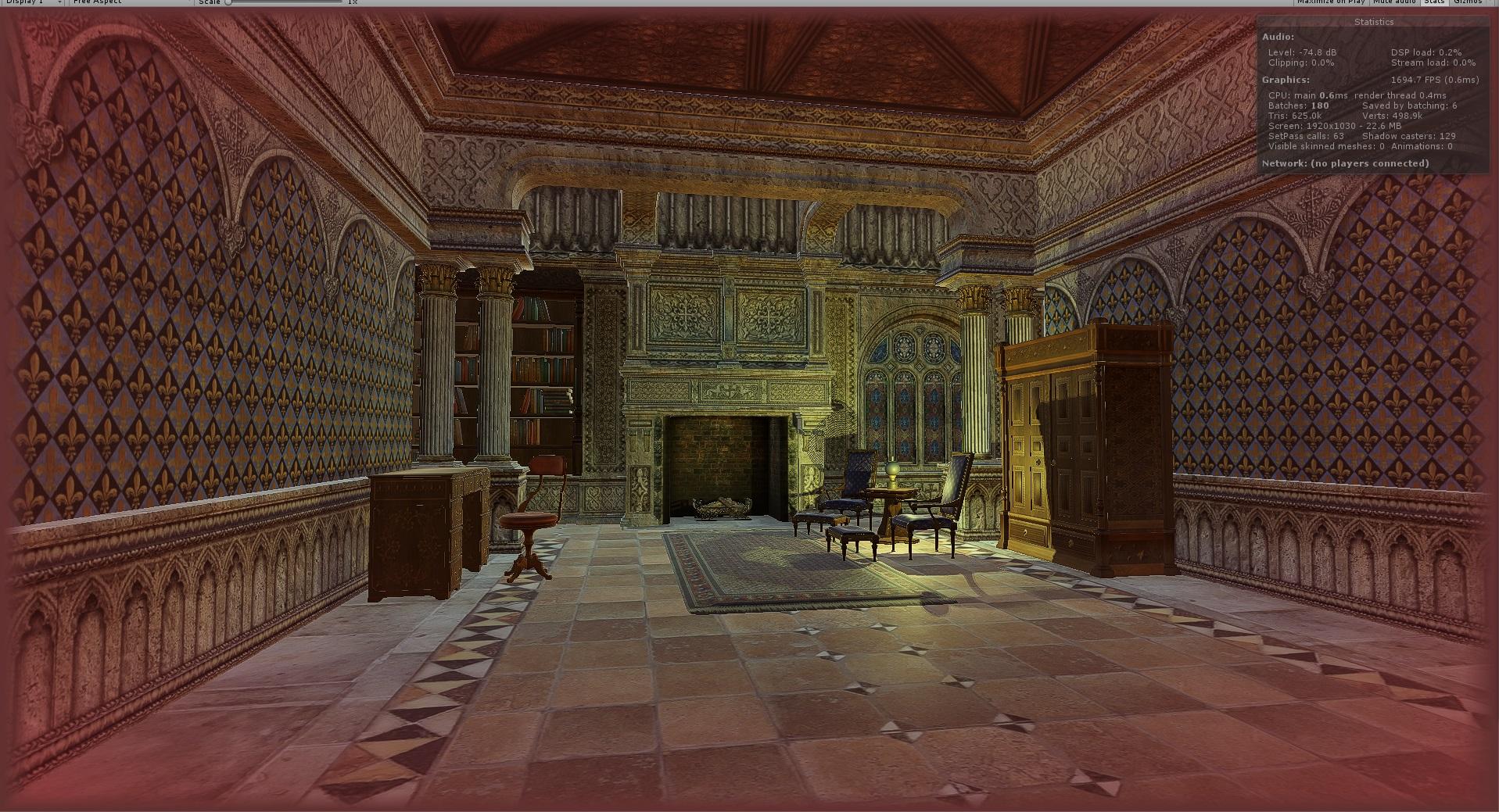

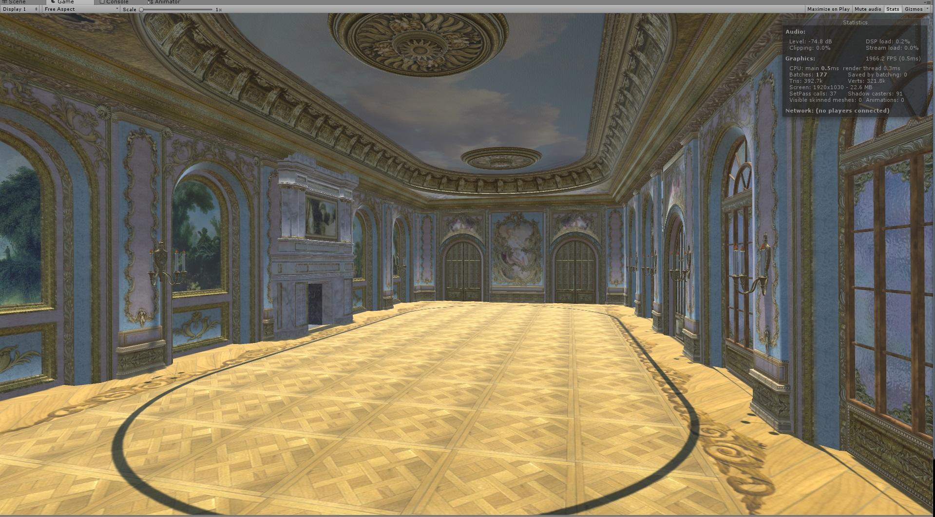

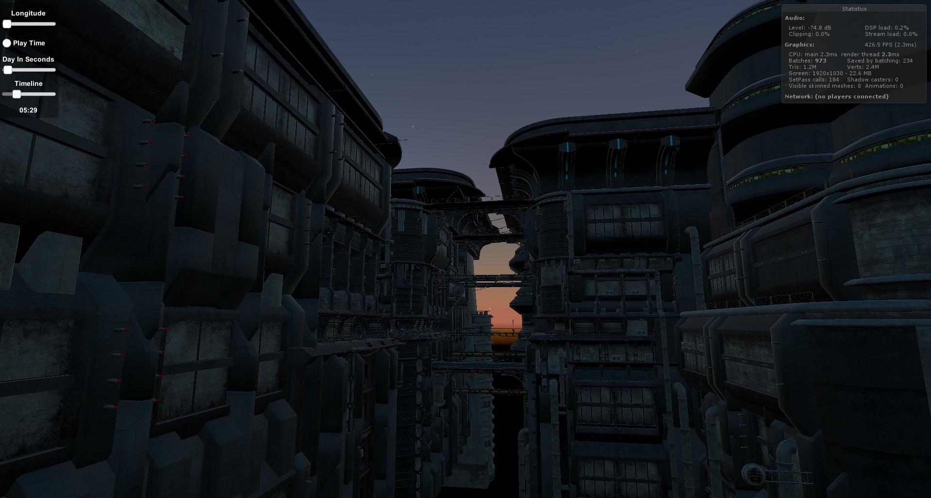

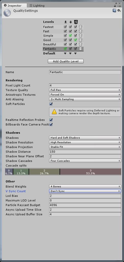

    Below is the screenshot from Unity 5.4.3 of Bal a Versailles, exported from Daz Studio as .fbx (Binary 2014) and drag and dropped to Unity assets folder.
    I disabled V-sync, to check out how much frames per second, one can have. In Unity I used Forward, Gamma rendering path and one Directional Light.
    If you are not making a game in Unity, you do not need to decimate Bal a Versailles set, because it contains many small props with not so many vertices.
    Unity has a limit of 64 K vertices per mesh and if it is larger than the limit, it just splits the mesh to several submeshes (but it is not the case with Bal a Versailles).
    1919 x 1061 - 696K
    485 x 1021 - 115K
    Post edited by Artini on

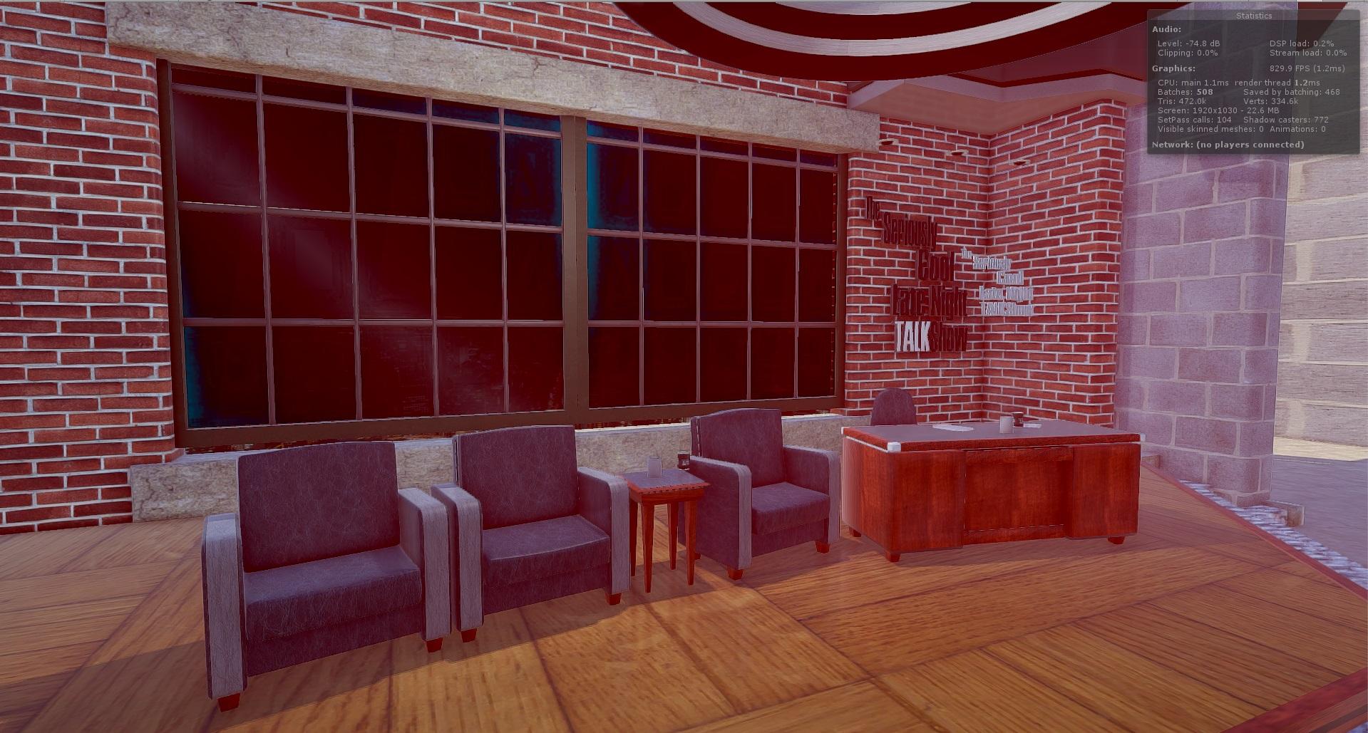

  • That's wonderful and need to say I’m honored from so many helps from experts. What's your GPU? Also appear much darker than the original, I suppose the illumination make the difference.
  • ArtiniArtini Posts: 10,903
    I have Nvidia GTX 1080 graphic card. I will try to add some mesh lights to the scene and remove the directional light.
    edited January 2017

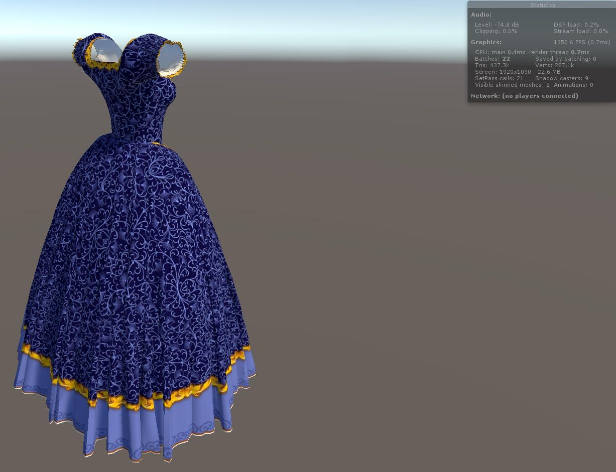

    This is an example screenshot from Unity with two point lights and disabled directional light. Deferred rendering mode.

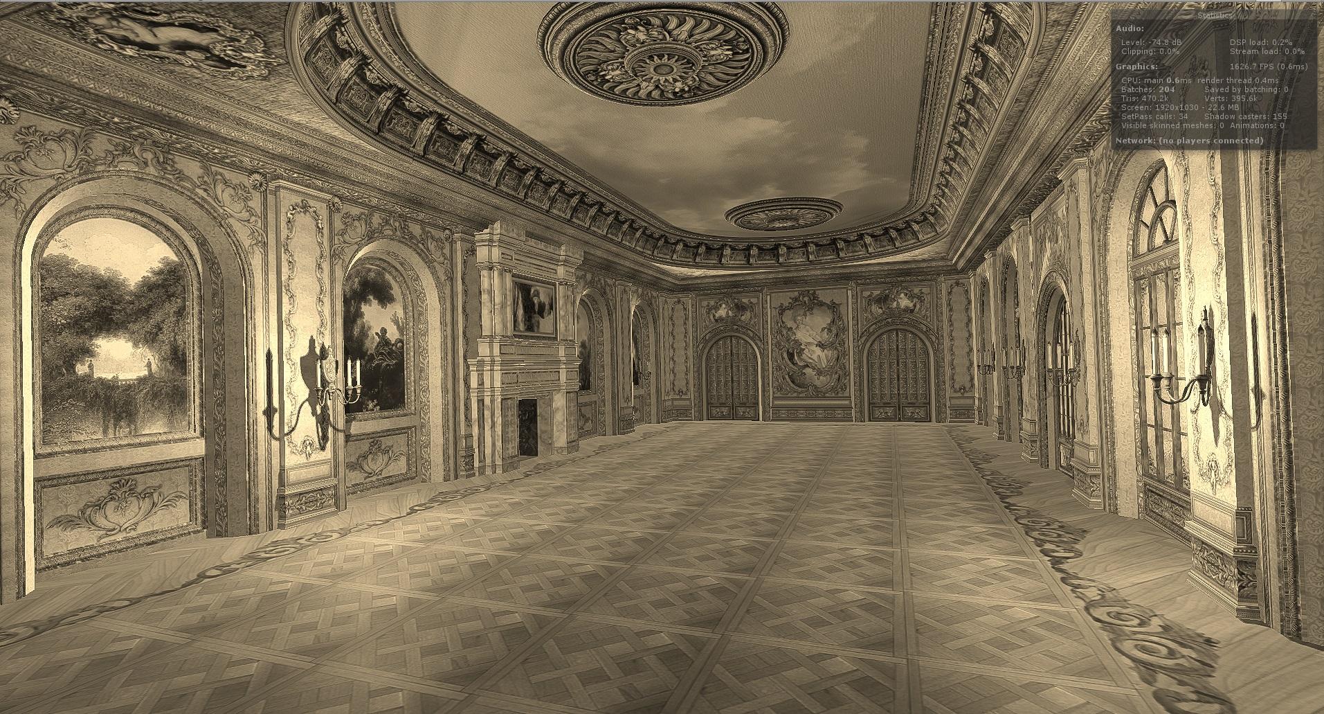

    ... and with Sepia post effect.
    1917 x 1033 - 455K
